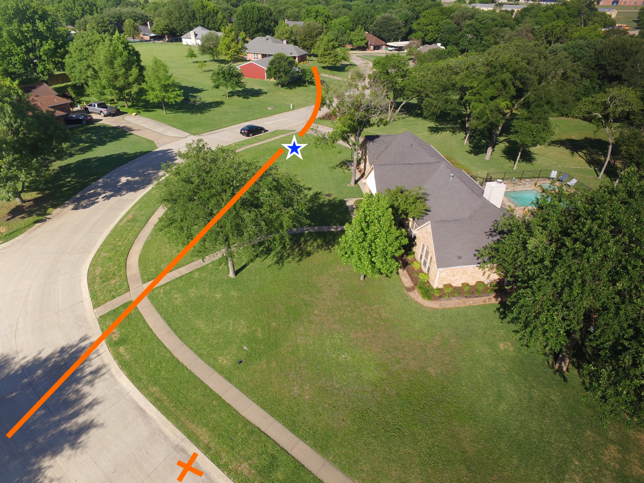

My P3P went into Atti mode and became very difficult to maneuver. I panicked of course, and tried to work the controls, but it seemed to be flying away near some houses, so I cut the power and crashed. My question is what should I have done, and will a 100 ft. geofence still be in place if the P3P goes into Atti mode?
FYI, there APPEARS to be no damage to the drone. If it visually looks ok, and will start up and respond to controls, should it be safe to continue?

It would also be helpful if you can describe your launch spot.
What was the surface you launched from?

Thank you for your kind and helpful comments. I will get the log ready and submit it. It started down the street near the red barn. I was able to get it back into my yard and attempted to bring it down near the blue star, but it went out of control and headed across the street towards my neighbors house all the while spiraling. Going in a straight line but spinning around. That was very puzzling to me. It was at around 40' altitude, just above the trees and I only had about 3 seconds till it would have been out of VLOS. I did not turn off the RC. I pulled both sticks down to opposite corners and crashed it right on the orange X. The battery shot out, two flashing light covers came off and one of the white gimbal cushions. There is a hairline crack near the battery compartment and a dent on one of the arms. Looks pretty good considering.

As I guessed, you had a Yaw Error situation, which will have been caused by launching from a magnetically distorted area.
Atti mode was just a symptom of the problem and not the cause.
You were fortunate yours was only at low speed and that you were able to recover the drone.
Many don't end so well.
What was the launch surface?
Was the Phantom facing toward the south at the launch?
