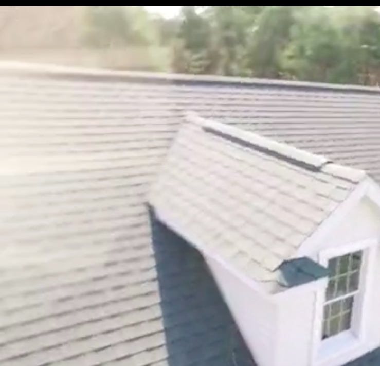

I did have a spotter - my young son was in the front yard not far from me. I was controlling from the side yard and only steps away from full view. With those few steps I watched the camera come rolling off the roof. Definitely no bird strike. No feathers or guts, and my son saw no bird. I agree - it looks like something wacked it. It did not hit the roof obstruction. I went back up and looked for the slightest nicks - also looked for feathers just for the heck of it. Tried hooking P3 up to my Mac with the micro USB - it doesn't show up at all so I'll need to speak with DJI regarding what to do.

If you look at each frame in turn just as you clear the roof line, something comes from the left, its a shadow and its gone again in a blink. (the haze to the left).
The next frame you see the camera pointing at the arm and you see the blade.
I still think a bird hit the phantom.
It nocked it off course had due to proximity to roof had no time to recover.

Yea just watched it frame by frame and like you say in the top left something appears to happen before the fall. Some sort of shadowing or bubble comes into view. strange one. Me and my wife have watched that video 20 times now i bet and we didnt pick up on that. hawk eye. well spotted
Looks like it was hit to me, likely a bird. It wasn't a loss of power all the lights were still on. It seems like it moved like it was impacted so I don't think a motor locked up.
Looks like the sun glinting off a piece of dust on the lens. Just the right angle, it seems to build as the craft rotates left and into the sun. It also appears to be too circular, like a speck of dirt or debris.

You definitely did not hit the dormer. Just as the camera gets hit, you can see the see the second dormer fully below the camera. That means that the first dormer was also below the camera. It could be a bird, a squirrel or maybe a chimpanzee.

The blob that enters the picture is THE PROPS! I checked the original footage and found a few more frames - also froze a frame to show TWO props

I went back and did a second video edit - this time I slowed the video down to 30%. No bird strike. My son would have seen it, and I was close enough that I would have seen something.
Again, the blob entering from the left is definitely the prop.
That's what I saw and why in my post above that I felt like there was a collision form the outside - I still like the bird idea. Something caused the left front prop to suddenly come into view then return back out of the frame.

The rear right motor could of gone into full power
