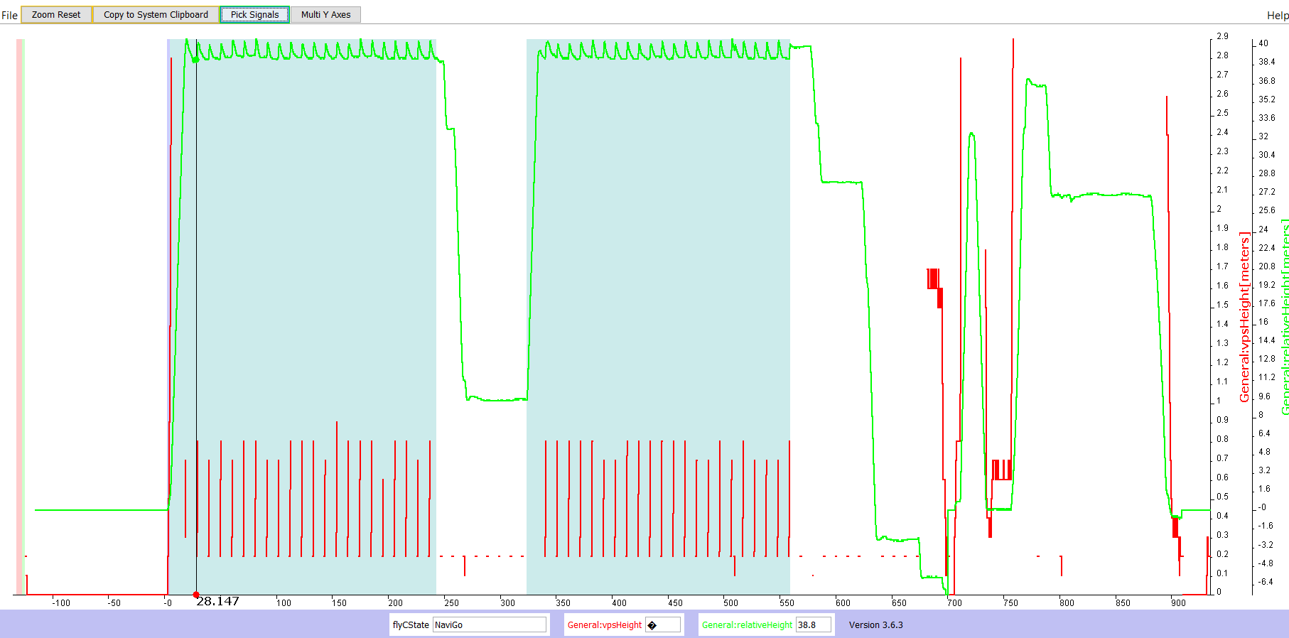

Part way through a Litchi flight (at the 2 minute 6 second mark), the P3P ascends and descends 3-5 feet (quickly) and repeats this numerous times during the mission.
Once this “bouncing” starts, it repeats (the increase and decrease in altitude) every 10 seconds (almost exactly).
Also at 2 minutes and 6 seconds, per airdata, the “sonar” kicks in, and gives errant altitude data…2- 3 feet and less, and this also captured in the airdata file.
During these intervals, the “real” altitude increases and decreases too.
This is most unusual data. It appears this is a VPS issue, however, you were in and out of mission mode as well for whatever reason that was. Looking at the VPS, these signals are very abnormal. I think you have an issue with the aircraft of some sort. Turning the VPS off may eliminate the issue, but just IMO your VPS is not working at all correctly.
but I have a feeling it is a symptom that could be related to other issues....
That is why I mentioned a possible aircraft issue of some sort. This is not related to the app's at all though it appears. I haven't looked at the second file you posted as of yet. If it exhibits a similar profile, then it is either due to the VPS completely malfunctioning ( Which it certainly looks like )....or a combination of another issue with the AC.

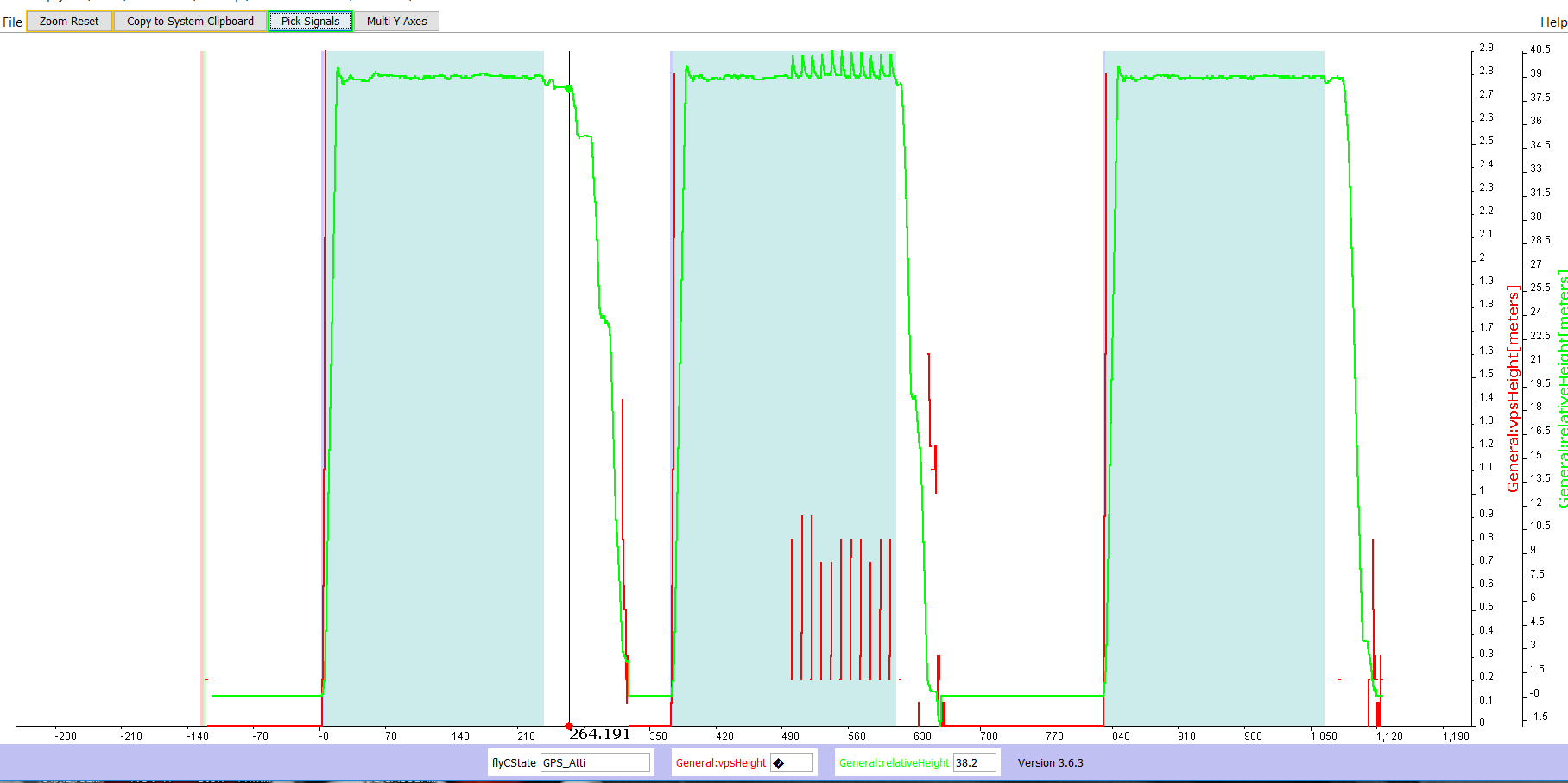

Second flight file.....Same response......Definitely a VPS issue and not one that I have seen. It appears completely disfunctional....OR at a wild guess something under the aicraft is blocking the signal....but honestly it doesnt look like that is the case, although possible.
