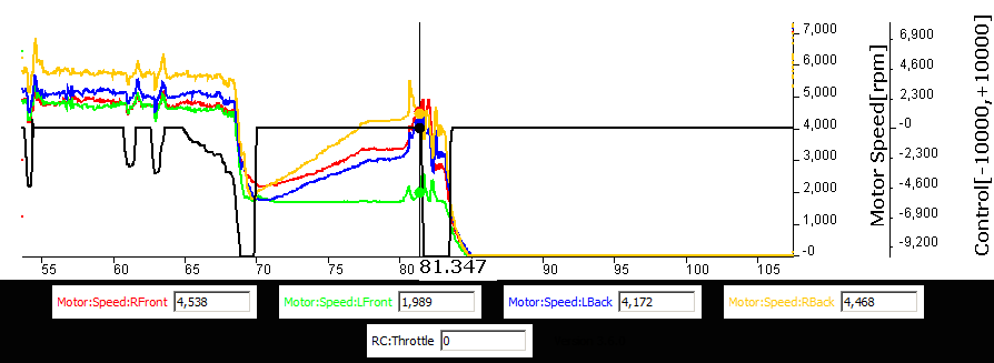

This one doesn't seem to have a fly away incident that you've been describing. But, it does show the motors not idling after you've "landed" it. The quotes are because, although it's sitting on the ground the P3 doesn't think it's landed. Here's an example where this happened
The leftFront is idling but the other three are still trying to level the P3. Note, that the P3 doesn't even think it's near the ground at this point. Isn't this normal behavior?

Thanks @BudWalker . I admit to being a bit confused, but couldn't the activity starting at 69.187 represent a flyaway situation? The drop to 0 rpm at aprox. 84 sec. would be what I would expect to see, given that I immediately pulled the throttle to zero. So if only 3 motors are responding, couldn't that account for the flyaway? Also, what defect would cause the bird not to know it is on the ground?
Just to recap, here is a description of the flyaway situation:
The bird has been landed, and it's sitting on the ground, idling.
The motor speeds seem to drift. They may drop, almost to zero, or they may increase, even to the point of lifting one end off the ground, with fingers off the sticks. I have recalibrated the controllers, and it does it with 2 different controllers (his and mine, both the same behavior)
If you try to takeoff, instead of moving straight up, it moves to one side, at relatively high speed, (I have seen backwards movement as well) just inches off the ground.
At that point, the only option is to pull down on the throttle, hopefully shutting off the motors, before it hits something.
At altitude, flight seems normal.

OK guys, the CsvView is what I was looking for. You have created a monster.
I have a new dat file. In this file, there are 2 normal takeoffs, hovers, and landings. After the second landing, while the bird is idling on the ground is where the fun begins. At 124 sec., the right back motor control signal goes flat at a constant value of 14.67, while the other three start to increase. This is what I was talking about when I said the motor speeds would start to increase on their own until it would start to lift one side of the bird off the ground.
When the throttle is increased to try to take off in this condition, that is when the flyaway happens. I was hoping it was the motor, because that would be an easy, cheap replacement. But it looks like the issue is whatever is causing that pwm signal for the right back motor to go flat. The motor just appears to be doing what it's told. It's weird that when throttle is applied, the right back pwm signal responds, and starts to look normal again.
I suspect that the failure is something in the motor control circuitry for the right back motor, but I don't know enough about how that is done on the P3P to say for sure. If anyone knows of any information on how this is done, please point me in that direction. As always, any input is appreciated, and thanks again.
But, by your description they aren't idling.
Doesn't the plot show the behavior you're describing?
I don't think it's a defect that the P3 didn't know it's on the ground. It's not as smart and waits for the IMU data to say it isn't descending when the control inputs would be causing it to descend if it were not on the ground. You know it thinks it's landed when the motors stop. The eventLog stream shows it didn't think it had landed until 83 secs.

Kinda looks to me like full negative throttle caused it to descend until it touched the ground. But the negative throttle was released before the P3 could see the negative throttle and not descending. The next negative throttle was at 81 secs and was long enough for the P3 to see the negative throttle and not descending.
BTW, the full negative throttle is coincident with a small amount of positive rudder.Maybe the throttle isn't being pulled straight back.

So you think that this is normal? Because it doesn't act like any P3P I've ever flown, and I've flown several.
I don't actually know since I've never done this with my P3P. I always pull the throttle back until the motors quit.The behavior seems normal to me given that the P3P doesn't think it's landed. The question you should be asking is why the P3P doesn't think it's landed. You'll need to use DatCon to see the eventLog stream which will show if the P3P thinks it has landed.
So if it doesn't think it has landed, then it's sitting on the ground trying to maintain level flight. That would explain why the first takeoff is always good. It would also explain the rough landings. I'll have to look into this further I guess.
@dmiles One other thing I noticed and forgot to mention. It's not always the leftBack that is slowest and flatlined. It can also be the leftFront and rightFront.
Soooooo, I'm embarrassed. If you land but do not shut down the motors, the P3 doesn't know you landed. I tried the same thing with my P3P, and it does the exact same thing. In over 4 years of flying Phantoms, I never knew this. Thanks for your time, sorry to have wasted it. I did learn a lot, so hopefully it wasn't a total waste. It looks like there is actually nothing wrong with my buddies P3P after all. Now he claims it's better since we did the IMU calibration. Who knows, the first time we did it I did the IMU test, and it did say it was required. Looks like we just made up the other problem.
For what it's worth, my P4P doesn't do this if you land without shutting down the motors. All the motors just idle normally.
