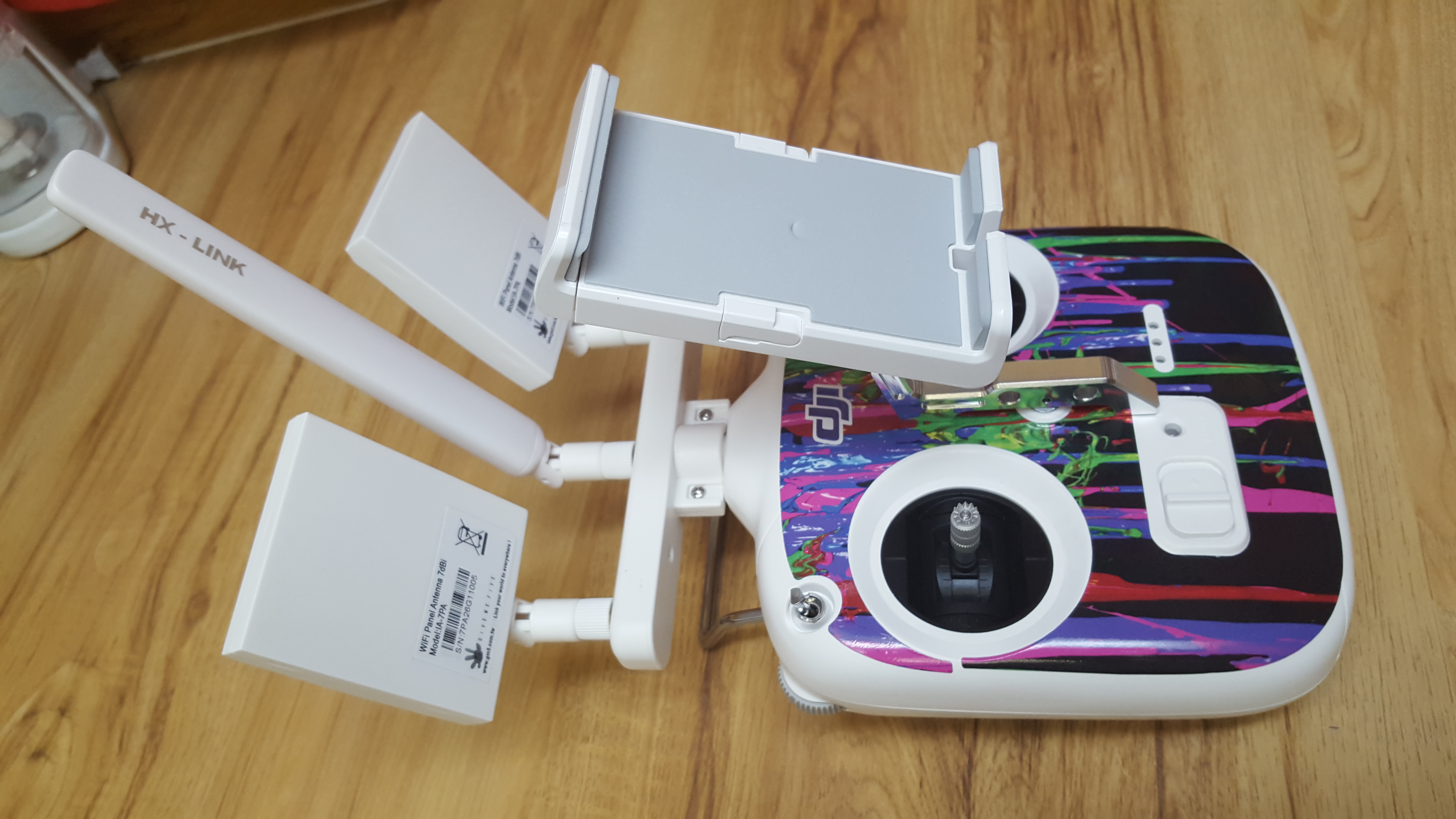

the argtek has doubled my distance from 1200 feet to at least 2500 feet in a very congested neighborhood

I am sending my P3Pro controller to Jake at Max UAV Very soon but need something else for the standard. So the DBS Mod Seems to be the favorite and most reliable from what I have seen on here. Can I ask for a few links if someone has time to hook me up to a joint that sells this bit of kit??
