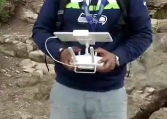

Also, learn a lesson from the picture of your antenna orientation. That is most likely the reason you lost signal.
