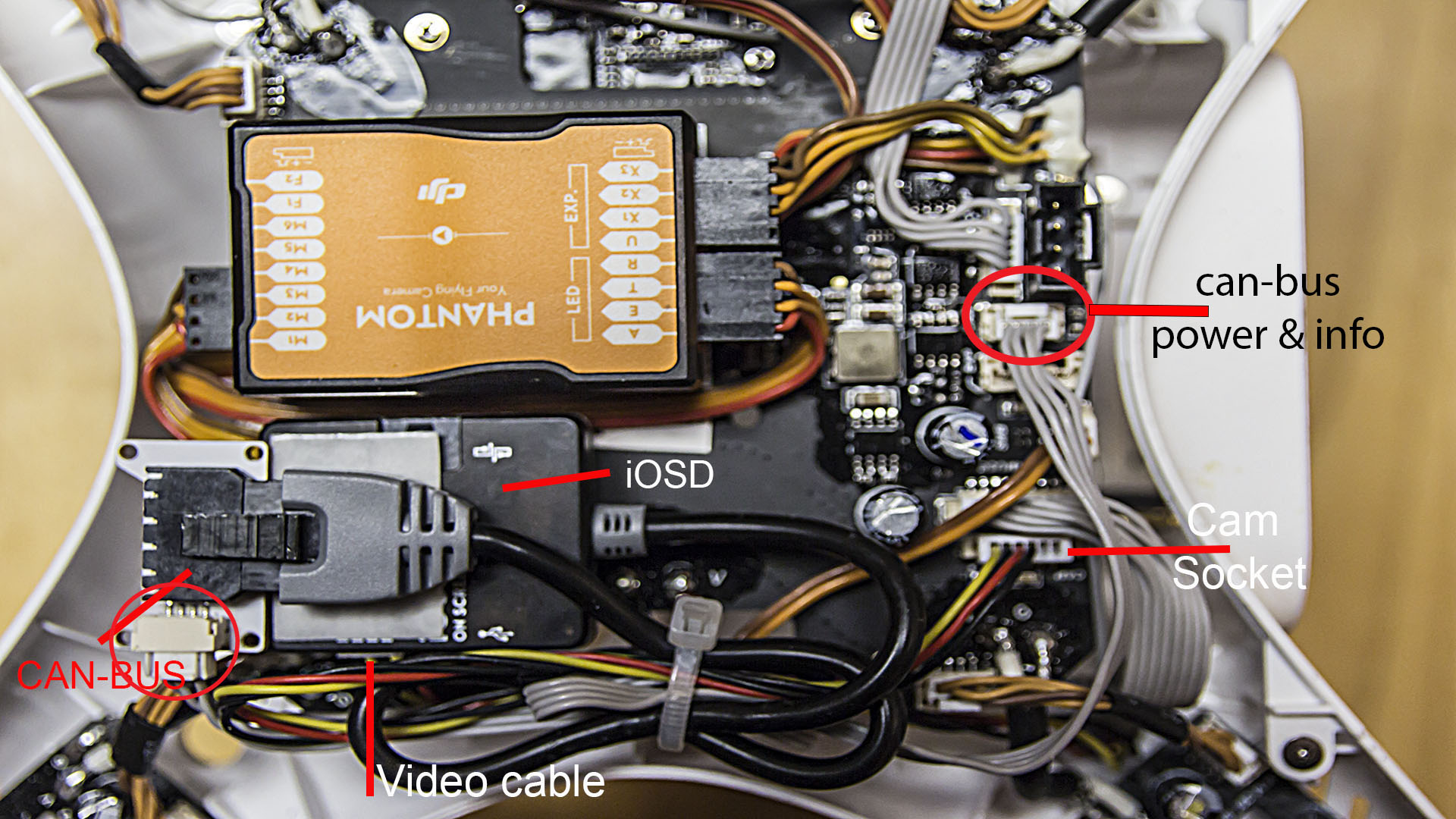

There's only one way that the USB cable can be connected to the Naza module. Here's a photo of the Naza module. The USB cable co9nnector from left to right is orange, yellow, yellow, and brown.

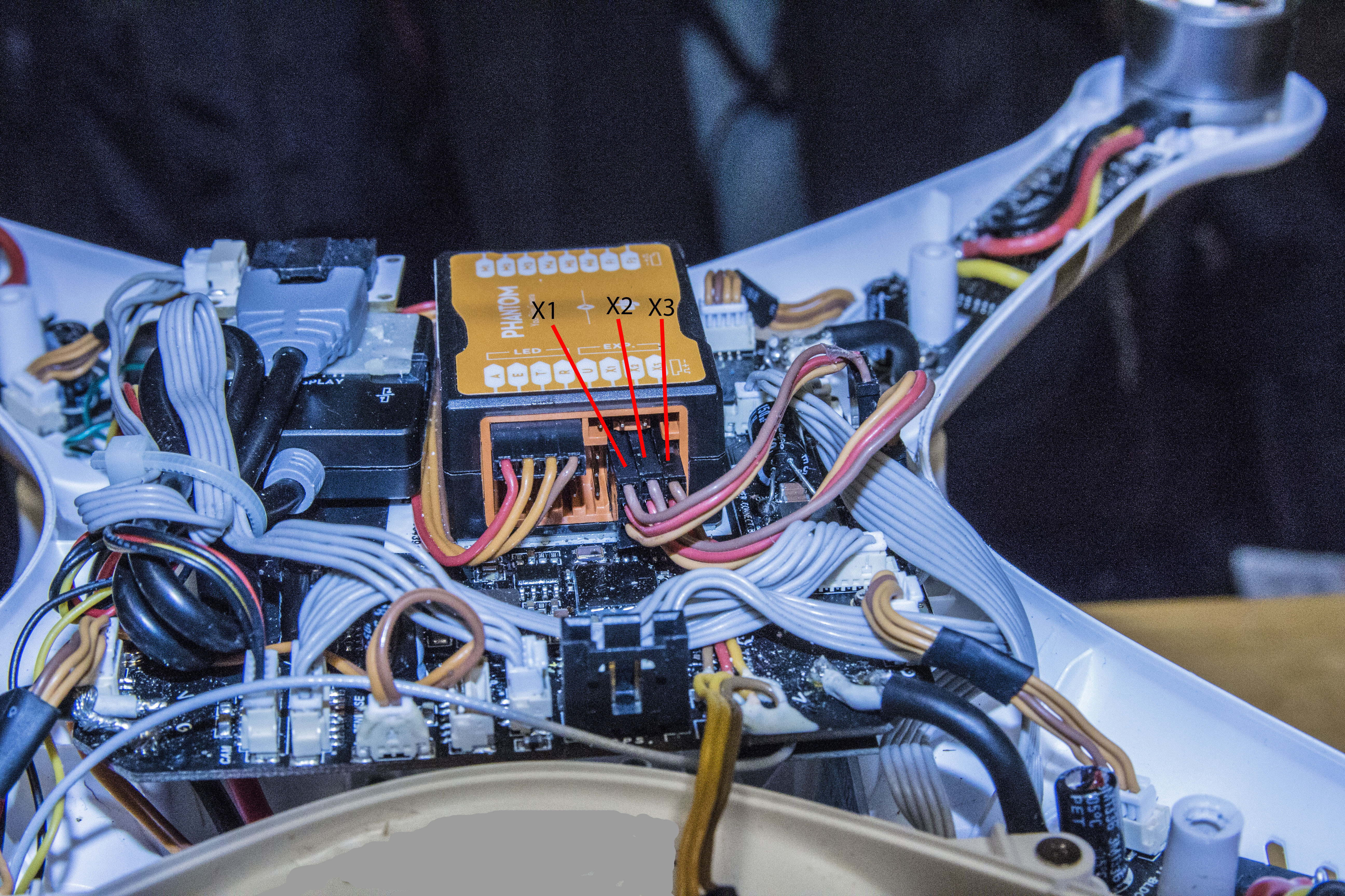

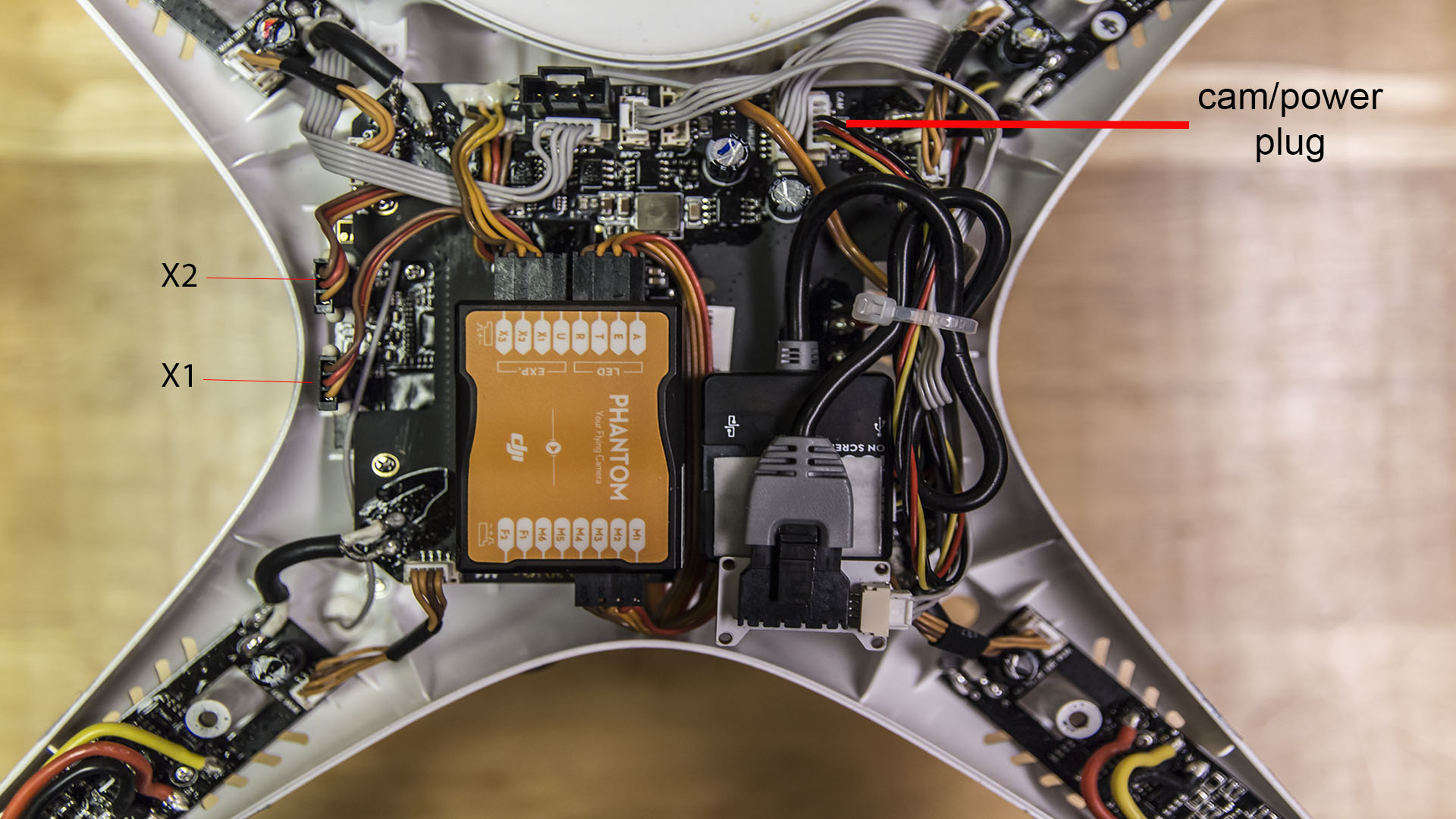

Have you the 1.4 users manual? Are you sure that 2.4GHz receiver cables were connected correctly to the Naza module?
If those receiver connections are not connected correctly there will be no communications with the controller. If you're not pairing the controller to P2 correctly that could be another reason you're having problems.
Here are two photos of the receiver wiring.
