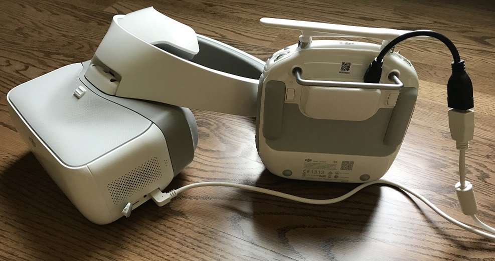

I just did. And a P4P. I am now at a loss as to how I can (1) have the DJI Go 4 App connected via phone or similar device AND have the Goggles connected via USB (I need the USB connection for the functionality). Would be grateful for any advice!!
Can't have it both ways if both are using the USB. Splitters don't seem to work on the RC USB.
In order to use a mobile device at the same time, you'll need to connect the DJI Goggles to the remote controller via an HDMI cable. If using the included cable, you'll need to use it along with a mini HDMI to HDMI adapter (like this one).
