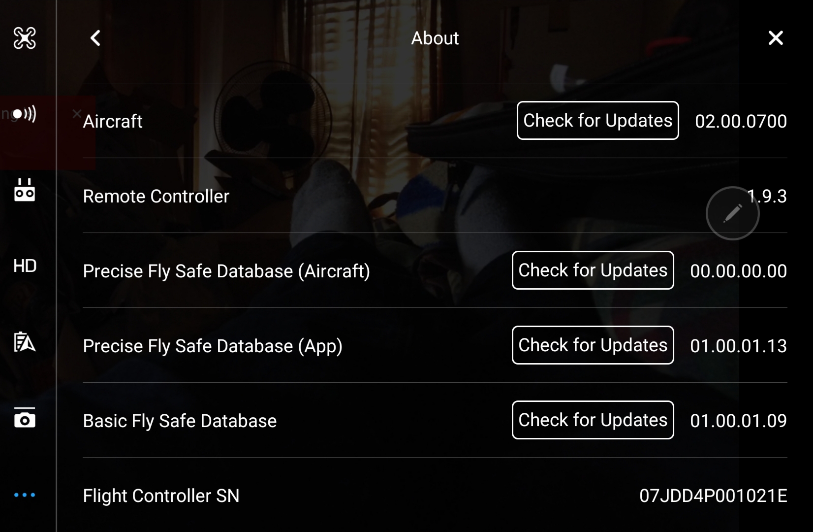

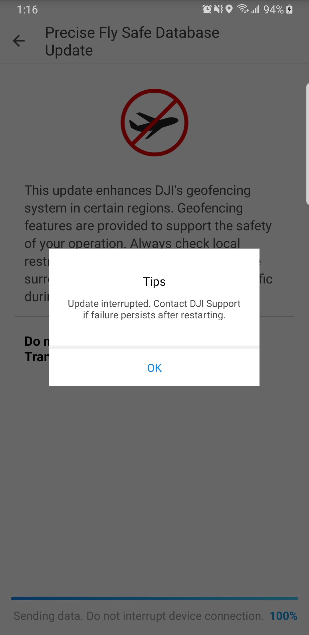

I tried everything to get this P4 to update and it fails everytime keeps saying it was interrupted. Any ideas or help would be appreciated?
Yesterday I did the fly-safe database update and now the version of the app as well as from the drone are 01.00.01.14!
And now I can use the new enhanced Geofencing zones. At least in my city the restrictions are gone, and that's exactly what the government also shows on their site!
So Phantom 4 users can now also upgrade to the latest "precise fly safe database"!

Had the same issue..switched my pro+ transmitter frequency from 2.4 to 5.8 and all updated. Maybe too much interference with your wifi on 2.4
