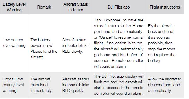

When it got to 10% I was informed that "critical battery level is reached, returning to home". The drone went straight up until it hit the trees, then fell about 40 feet and, well, you can imagine.
But guys I am trying to figure out why the response to critical low battery is to go into a "return to home" mode. You have 10% power and you're going to fly home? It gave me a 10 second warning, and I tried every combination of input to take back control of the drone I knew, to no avail. It was going home.
Just a warning on the new upgrade guys. Check carefully. Review the low battery level responses and all of that. I didn't, now I don't have a drone.

How very odd. It should auto land at critical battery, not RTH. Upload your flight log at the link below and lets see if we can find out why. Be sure and post a link back here for your log when uploaded.

After reading this again, you could have mistaken Low battery for Critical battery. At the low battery point it gives you the 10 second warning to cancel RTH. At critical battery the AC should auto land immediately with no warning. So is it possible that you simply did not cancel RTH at low battery?? The log can confirm that I believe.

No research required, its right there in the manual.
The issue the OP stated..
"When it got to 10% I was informed that "critical battery level is reached, returning to home". The drone went straight up until it hit the trees, then fell about 40 feet and, well, you can imagine."
I think it's the bold bit that isn't in the manual and which, ultimately, caused the issue hence why we need to see the log?

If the bird was going into RTH mode, the first thing it does is to climb to the preset RTH height! Sounds like that's what happened here. OP was unlucky in that the bird was under a tree branch lower than RTH height.
That's the odd thing though- and I agree with the OP in not understanding why at "critical low battery" it would do THE RTH ascend and Return.
No way it should have done anything else but land.
Even if it was over 20m away.
That's just wrong.

Unfortunately Richard, that not correct; in the case of a critically low battery - it just lands - see Fly Dawg post - its #8 above. This is the reason why we'd like to see the flight log, to ascertain why the AC suddenly ascended.
