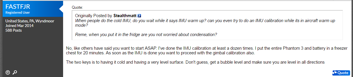

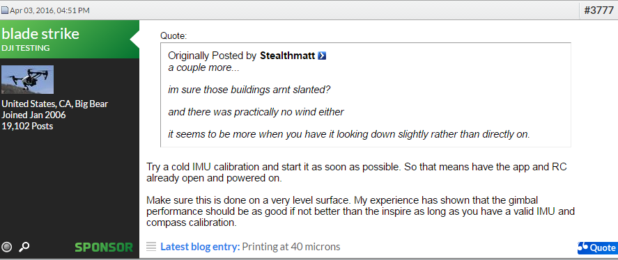

Both Blade and Tahoee on RC groups have said cold IMU calibrations.
This reply was in response to my first phantom 4 which had a bad horizon level - RC Groups - View Single Post - Official Phantom 4 ***Owner's Thread***
Well that's interesting. The calibration goes over the temperature spread... That also makes some sense.

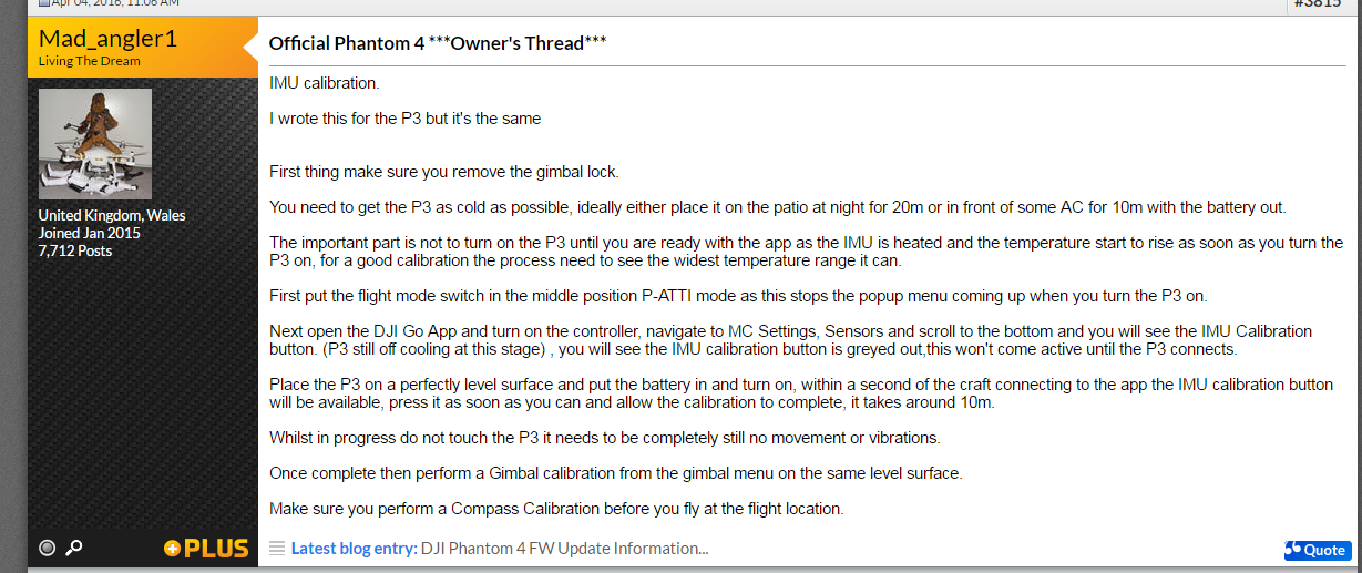

IMU has to be dead cold, i.e put it in the fridge for 30 minutes. and then before you even turn the phantom on, have the menu open ready to go. As soon as you turn the phantom on calibrate.
Use a spirit level to ensure the surface it is on is dead level, both ways (back to front) and (left to right)
I put mine in front of an airconditoner in a bed room for 30 minutes, got it down to 18degrees in the shell. My fan didnt turn on till around the 70% calibration mark. and now my phantom is dead level and like never moves in the air.
