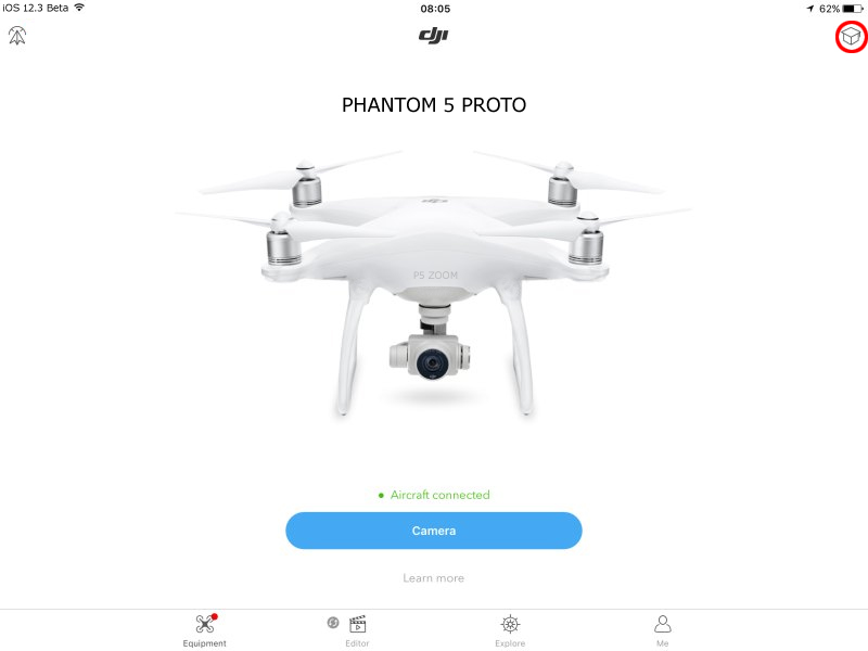

Mount your mobile device (the same which you used for the update) on the RC.
Ensure you have internet connectivity with your mobile device.
Power on the RC.
Launch the GO App
From the main connect screen, press and hold the Graduates Cap in the upper right corner for at least five (5) seconds (seems forever).. and then go...

Thanks, I'll try it as soon as I'm at home... We it ask me for upgrade again after downgraded?
I tried, I have maximum distance now just about 600m. It is disconnected after that... Had 2 drops after 500m, but I kept force it to go, and I got the 600m...bye bye 1 mile

I got the selection window, but it doesn't bring me any of the old firmwares... I was on the upgrader mobile, but I tried my other one too, no result. Can I download the old firmware to a folder where it can recognise that?
