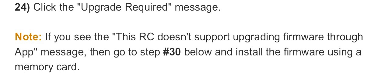

    When I tried to update the RC from within the app, I got the message
    which contradicts the new feature of being able to update the controller from within the app over WiFi. Why would my RC not support upgrading the firmware through the app?
    Manual updating worked fine with a USB stick, so that isn't the issue, but why the contradiction?

    The new app will allow FUTURE updates to the remote via the app but for now you have to follow the usb/sd card method - yes it is a bit contradictory I guess some things got lost in translation!

    I thought that this feature was supposedly created by the last firmware update, too. What I find most puzzling is that everyone's instructions for a successful update implies that you can somehow update the RC over WiFi, but only if that doesn't work, will manually updating be necessary. Yet, no one can update the RC without doing it manually. Only adds to the confusion. You have to update the RC manually. Stop confusing people. :cool:
