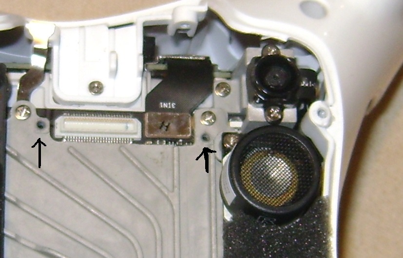

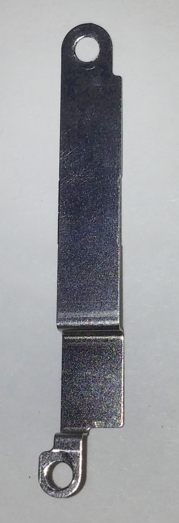

Hi Here is the background information I have bought a P4P without the camera & its shell which screws to drone first question how can I tell what version it is for instance P4Pv1 or P4Pv2 or the P4P+ models and are parts interchangeable also where can I buy the screws that hold camera shell on drone plus I need the 2 screws and flat metal bar that clamps down the camera ribbon to drone Thank You for all your help in advance
Need these 2 screws
