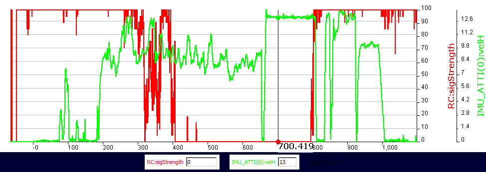

I’m also curious as to how I can get simple speed out of it as a time series.
If you are looking for an airspeed vs time series, it would be much easier to use the .txt device log for that.
DatCon will compute a ground speed, maybe this is what @bsartist wanted (as opposed to airspeed).

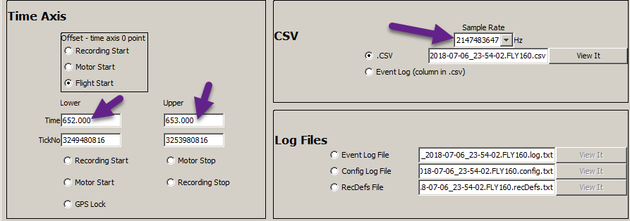

Did you use datcon to get an excel viewable file? Or is there a way with CsvView? AFAIU CsvView is doing the conversion internally.

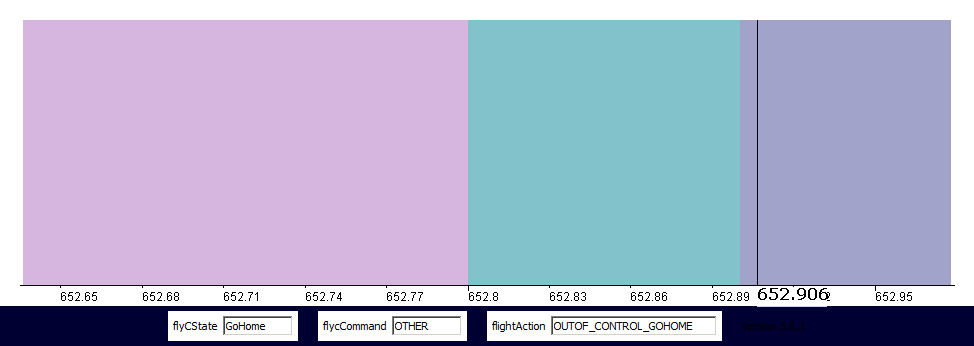

To see that the mission was cancelled you'll need to use DatCon and look at the eventLog stream.
652.778 : 35877 [L-FLYLIMIT]get 1860 data err:9 188
652.783 : 35878 [L-CFG][record_wp_break_point] save(&g_real.config.waypoint_break_point.lon)
652.783 : 35878 [L-MIS][WP MISSION STOP] Record wp break point:41 (-73.755883 42.828116 103.432526)
652.783 : 35878 [L-MIS][WP MISSION STOP] Record wp break point id: 0
Then use CsvView to see that when the mission stopped there was 0.1 secs of SMART_POWER_GOHOME that was then followed by OUTOF_CONTROL_GOHOME.
EDIT: Although CsvView uses DatCon internally it's sometimes conveient to use DatCon directly to obtain a higher sample rate like I did here. Then use CsvView to look at the .csv that DatCon creates.
