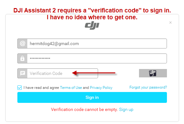

THANKS for your GREAT help, Dawg --- but I'm going in circles now. Your link specifically states that I need to use the DJI Assistant 2: "Retrieving a .DAT from the AC requires using the DJI Assistant 2 Version 1.1.6 or later. The version can be seen in the lower right part of the DJI Assistant 2."
I've installed the DJI Assistant 2 and tried to run it several times, but every time I try to sign in, I get this:
I've chatted online with DJI Support about this. They told me to sign up again with a different name -- I did that and tried to login using that name and email address, got the same sign-in window with no verification code.
I'm going to contact a drone repair service. THANKS again, Dawg.
