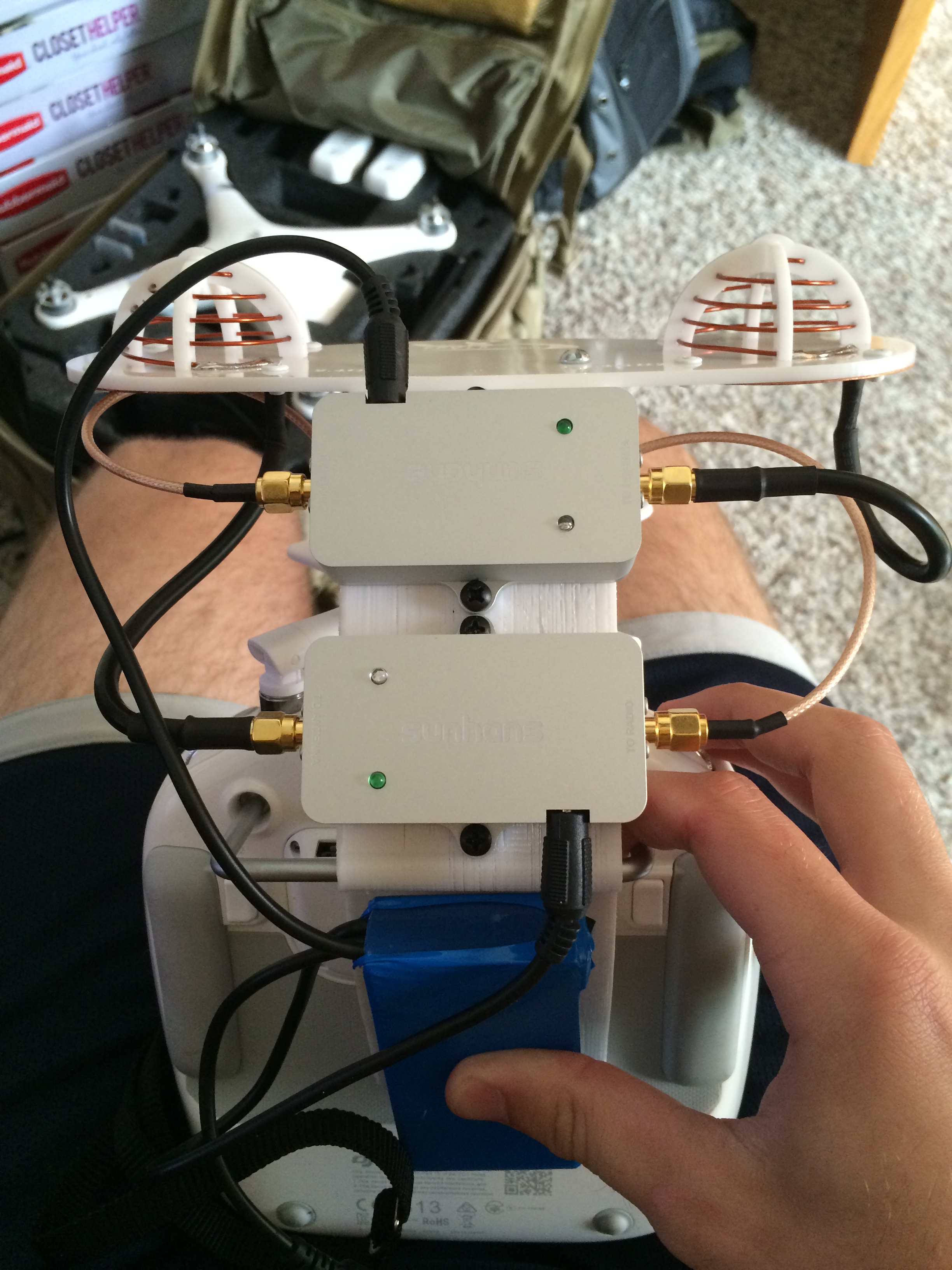

Yeah all you do is swap the wires around.

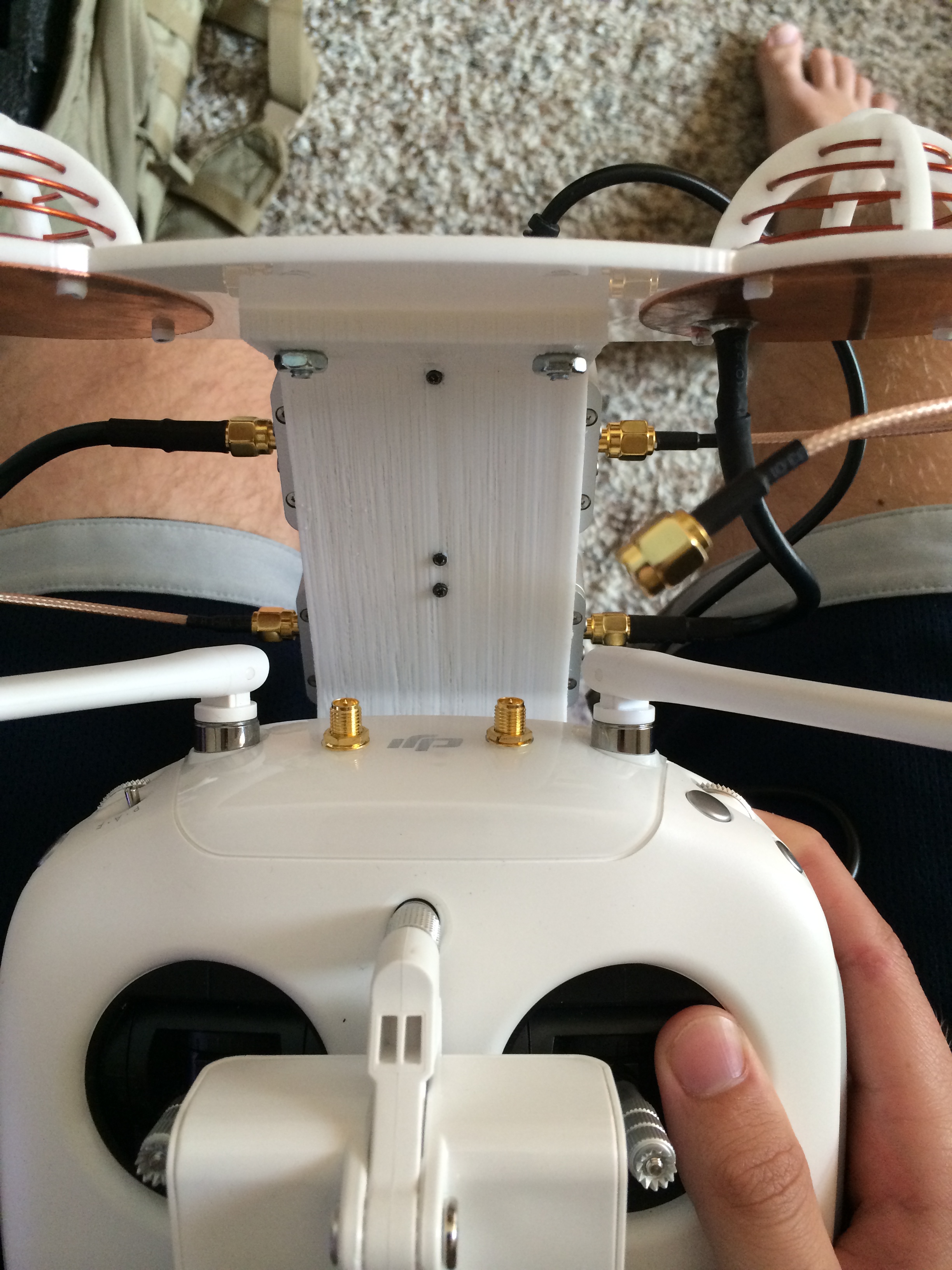

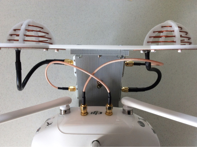

Here is what the wiring looks like from the back:

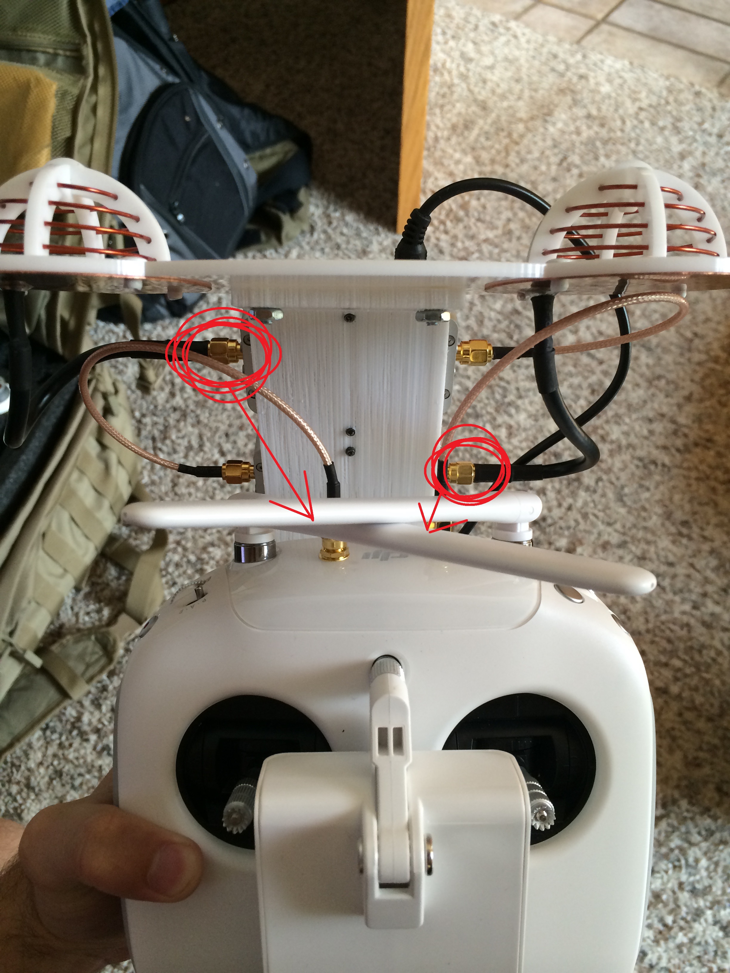

then you just unplug the copper looking wires and swap them with the black wires from the antenna, here's a pic of removing the copper-looking ones:
and here's a diagram of what swaps:

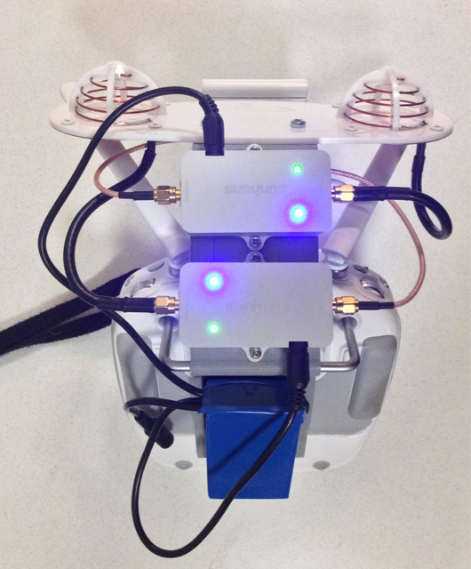

I do the same depending on the range required. The other day I didn't need the boosters so rewired and bypassed the boosters. Attached is a pic of the unit using the boosters.
Apologies for the poor image due bad lighting and shooting with the iPad but here is the underside with boosters visible.
