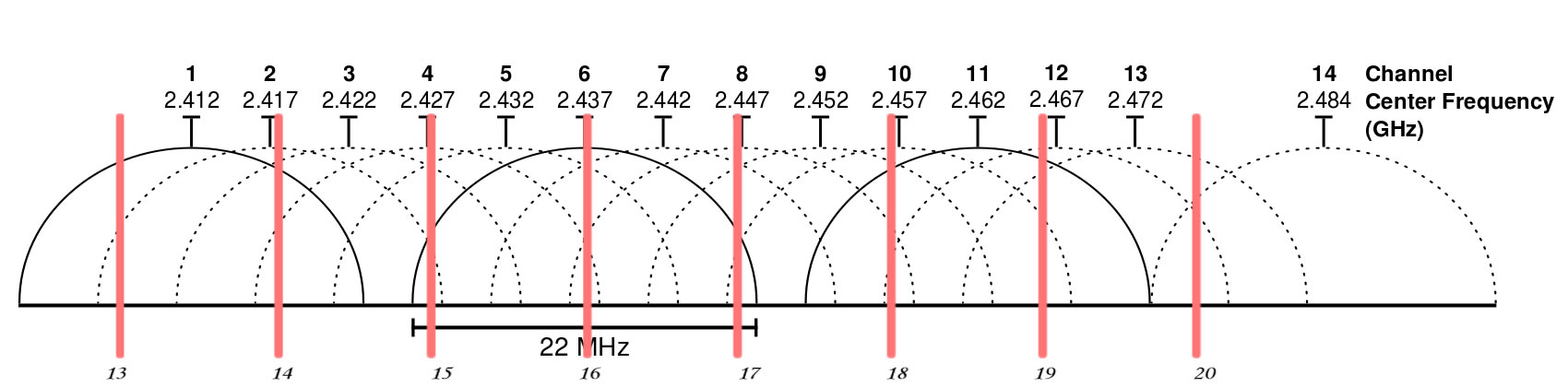

The protocol is not WiFi, but the frequency spectrum is still in WiFi segment. Correct?
If it was "WiFi" we would see the Phantom on our networks which we don't.
It appears this is close to how it lays out.
Very close.
According to the P3 Pro FCC report:
#1- 2406.5 then 10MHz intervals to #8- 2476.5MHz
The tests were perfomed on #s1, 4, & 8 (L - M - H)
I use # loosely to match the FCC report.
Correct but those are wifi standard channels. DJI channels will not match the same.
Same spectrum but two different protocols.
No need. The FCC reports contain all you need to know.
Besides, it's an assumption that the LB proper is the same as the P3 link. For one thing the P3 uses 4 antennas on the airborne side while the LB proper is just two.
Yes, it is not Wifi, but some of the DJi channels intrude on the WiFi band.
That spectrum analyzer report and the chart above corroborates what 43k saw and what I just experienced while changing my router frequencies. Only DJi channels 13 through 20 were effected, because those 8 DJi channels reside in the WiFi band.
So, choose any channel other than those 8 and you should see less interference from WiFi sources since DJi channels 1 - 12 and 21 - 32 are outside the WiFi band.
Disregard any of my charts, they are incorrect.
