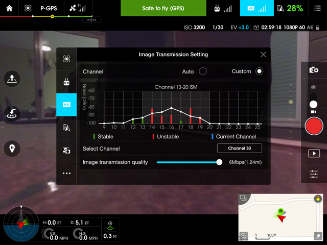

I applied the channel hack but did not get any further distance in fact on a known route I'd say I got less distance. I read pretty much this whole thread to educate myself and applied a couple pictures. Is this one of those your results may vary deals? Where not everyone will achieve better distance?

Why not list your complete setup for comparison purposes? Also where is your Maps at? You sure don't fly with your wifi disabled, do you?
Also why is your Image transmission quality jacked all the way up?

I put my iPad in airplane mode thinking it would increase my reception. No?
I thought it defaults to image transmission at 6Mbps? I had a choice to change it all the way up to 10Mbps!

Flew the hack this evening. Works a treat. Sure is quiet up in those extra channels, except for some big spikes on 26 and 27 where I was. I settled in on 31 and left it there for 4 batteries. Didn't try any distance comparisons, although some need to understand that it's only the video feed that's supposed to be better at longer distances, because the channels are quieter with less interference. I think that's the way I understood it.

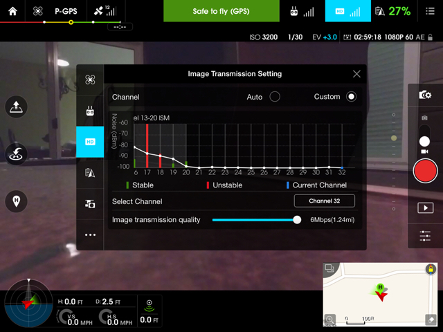

OK so why cant i get this to work lol. everything is current updates. Ipad mini3. Macbook pro running itunes 12. latest firmware on remote and on p3p. I have the config file. i go to itunes and do the add to go app and i see it within the go app folder in the itunes window. i sync my device and i start up my controller, app and bird....put it on manual. only have 8 channels still. What am I missing? read 16 pages of posts and as far as I know im doing everything correct....no dice! I also dont seem to be able to delete the config file from the itunes window either. i drag it to trash...it shows in trash but is still staying in itunes. (I do not have or know how to unhide hidden system folders...and dont care to if i dont need to).
Did you "unzip" the downloaded file before dropping it in iTunes? The file you download is a "rar" file that contains the actual 48 byte file you need to stick into iTunes. It doesn't work to put the file you download into iTunes without "unzipping".
yes file is unzipped. 48byte is what the unzipped file shows in my folder, once "add" to itunes it shows at 4kb on the itunes screen
screen shot of itunes showing the folder is in there. I have even tried to delete it but it wont let me
I didn't "sync" mine after dropping the file in there. Perhaps it's loading the old folder on sync? I don't know, just guessing.
not sure that would be the answer because they i could never sync my ipad like i do on a regular basis to back things up and such
when I drop the file to the desktop it doesnt show a period. When I try to rename the file to put in a period at the start of the file it tells me it cant do that as the period is used for system files only.
unhide my files and BOOM there we go. I couldnt see the DOT file. as soon as I could view the dot version I was able to drag it into the itunes file for the go app. Now the question is....how do i delete the other folder from itunes that is showing in the app screen for the NON dot file...or should i even worry about it
CORRECTION, its not working....while I see 32 channels. only 13-20 are available even while in custom mode. the rest of the channels are blacked out and not able to even see them in the "select channel" drop down menu.
