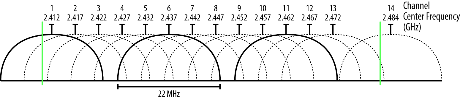

There are NO upper channels above 20. EDIT: THis is not correct. Mod adds channels above and below the stock 13-20.
First of all DJI apparently renamed the channels. They do not have their own special WiFi segment. The DJI specs show "2.400 GHz-2.483 GHz". This is in the standard Wifi range.
The added channels are between these green lines below. You can see one channel is already wide and covers several channels anyway.
32 is NOT higher than 14. 2,484 ghz is the highest frequency.
Note you have to move 6 channels before you don't get any overlap.
I am also surprised the can ship US phantoms with 12, 13 and 14 as those are not supposed to be US channels. Maybe there is some work around. I would be interested to hear it.
As I said I don't see how this works. Just asking !
You might have to consult DJI as to their channel numbering scheme. Either that or place your Phantom and Controller on a spectrum meter and test the channels on this mod to determine the frequency of the transmissions do determine/prove your inquiry. I'll be the first to admit. I don't know. I just enjoy flying my P3P uninhibited by the restraints that the most current app tried to keep me in. No energy on trying to reverse engineer why they number the things that they do. :)

The DJi channels are in red below. This was a quick modification of rrmccabe's drawing.

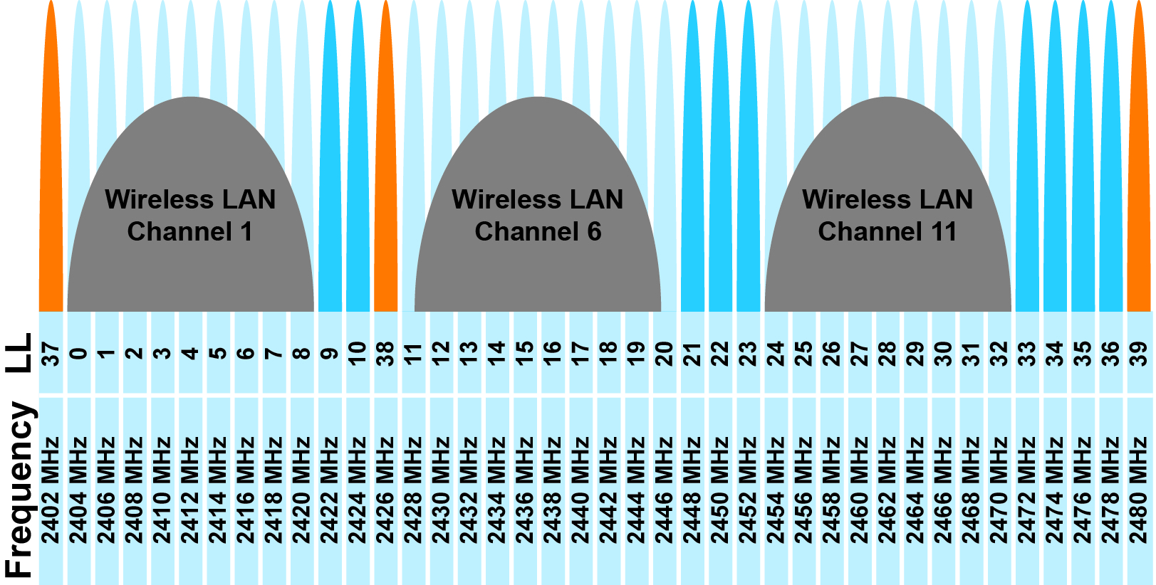

The config that you are installing is for RC only.
The system on the bird has a similar config but it is for 8ch only, so automatically it can't hop on all the ch of band AND it is the bird that start handshacking. If you plan to use 32ch extension you need to use custom settings with a fixed channel.
Going a bit technical TX/RX chips has 36ch, from 2405.376Mhz to 2477.056Mhz. Now DJI has a system that is 2 Mhz bandwidth channel spacing, and numbers are simply discretionary by the DJI.
The channel freq is : Freq (Mhz) = 2405.376 + 2048 * ( n-1) where (1 <= n <= 36).
This freq need to be in the ISM spectrum (FCC/EU will trash the system otherwise).
The DJI channels aren't the same as Wifi channels 1-14.
This render the idea also not stricly DJI Lightbridge channelization. As you can see Wifi and Blutooth are all jam packed in the range...
Thanks for this, Dome!
So, my question is like rmm's. If we accept that DJI's 32 channel spectrum within the FCC's 12 channel spectrum, then where does DJI's 8 channel spectrum fit? Is it equally distributed, meaning their 32 channel spectrum is adding a level if granularity and not necessarily range, or is it clumped at the bottom, meaning the 32 channel spectrum does add range (over the 8, not the FCC range)? Either could be of benefit, though the latter seems more so.
