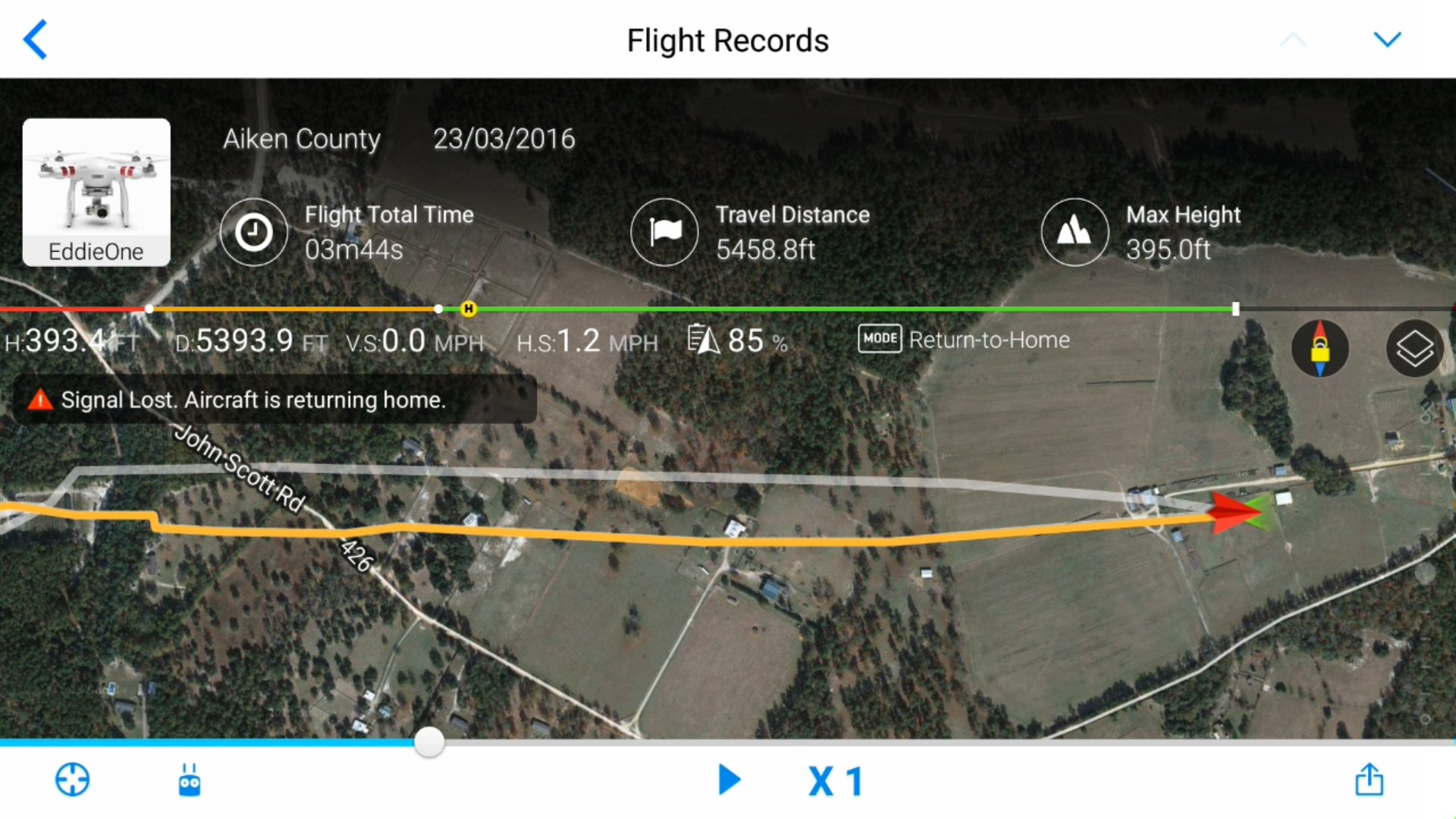

I finally made the club. Just barely, but my P3S with the DBS mod did daddy proud.
Reactions: dirkclod
I finally made the club. Just barely, but my P3S with the DBS mod did daddy proud.View attachment 48253
Good flight Tech :)

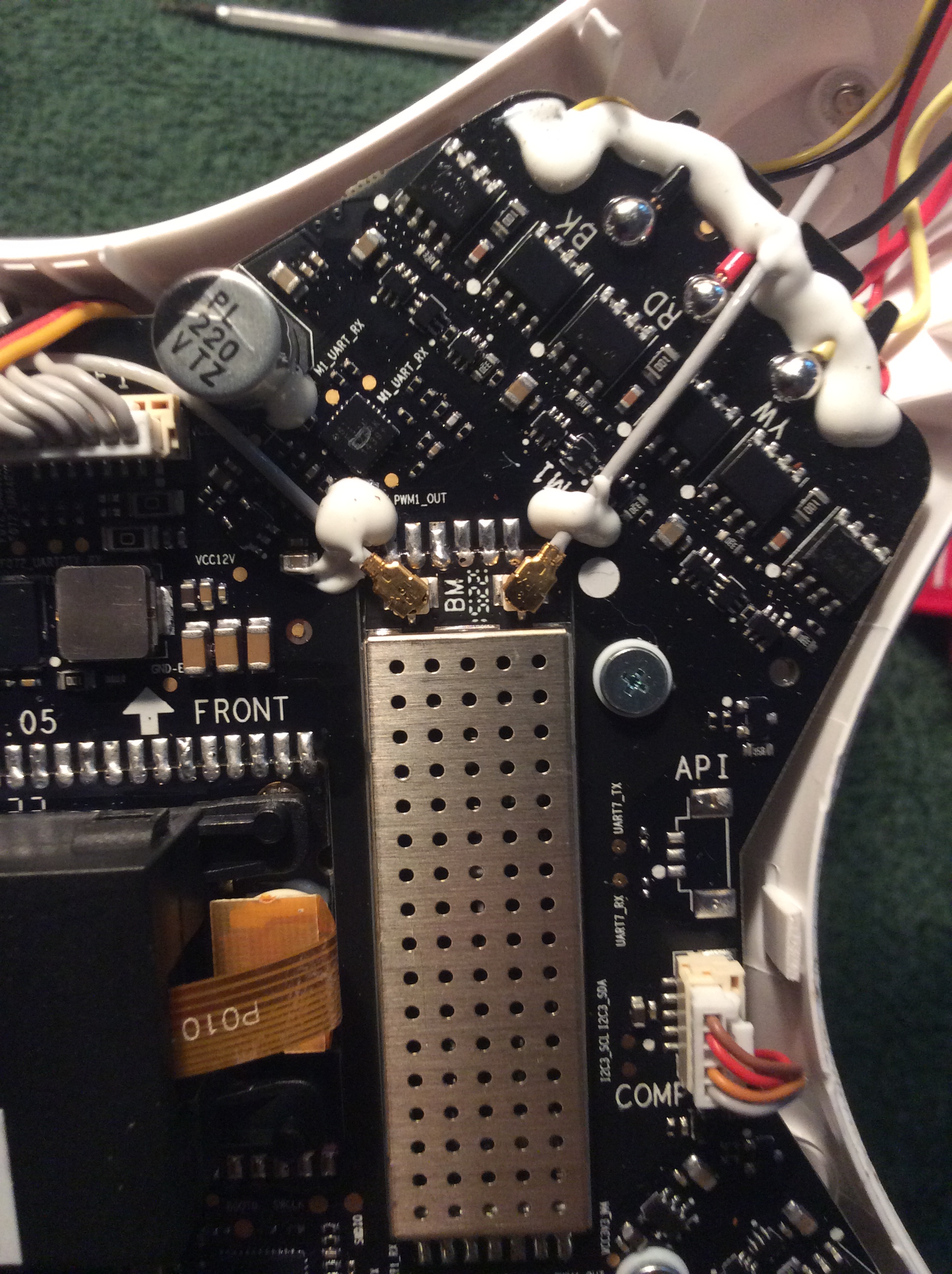

Im thinking about doing some birdside mods..
Do you by any chance know, when installing bird side 2.4 dipoles, do i have to remove the camera gimbal? Or can it be accomplished by just removing the top shell and drilling some holes.
Or is it a good idea to add the 5.8 anyway if i get it opened? i usually lose FPV way before 5.9 signal, because of wifi interference... some advice would be greatly appreciated.
after i started messing with the mods, its kinda hard to stop lol...
I need more distance!!! :)
Im going for the all time record of:
Sorry I just seen this buddy .
Yes you have to unplug the main cable and lower it .2.4's are here A2.png ( not my picture there ) Those covers are held in place by 2 screws on the other side .

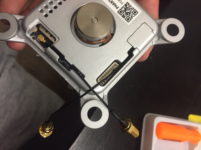

Your 5.8's are here IMG_1713.JPG Is not hard but you do have to be careful and just take your time .
It is addicting . Has had me 2 years doing mods .:)
Ya need to ask me anything hit me like this @dirkclod and will see the flag .

Great, thank you!! And you already answered most of my questions in another thread. I think i got all the info i need to get started :) Time to spend some moneeyy!...
