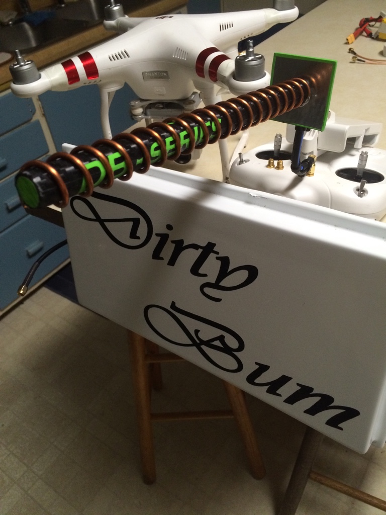

I'm not sure how the xtreme is gonna work! I know its very large and the pilot I spoke to says its arranged vertically stacked so its almost "tripod exclusive. But that pilot did say I could probably reconfigure it to sit side-by-side. Also I dont know if the one your getting will be the same as mine because Will is putting one together especially for me to test, I dont know if its prototype or stock extreme!! We'll see in a couple weeks. But rite now I'm freakin stoked about this bad boy
My chick said"that looks like it would hurt"[emoji41]

I'm not sure how the xtreme is gonna work! I know its very large and the pilot I spoke to says its arranged vertically stacked so its almost "tripod exclusive. But that pilot did say I could probably reconfigure it to sit side-by-side. Also I dont know if the one your getting will be the same as mine because Will is putting one together especially for me to test, I dont know if its prototype or stock extreme!! We'll see in a couple weeks. But rite now I'm freakin stoked about this bad boy View attachment 54474
hahahahaha! that's a beast! Procharged hooked you up??
Better then jealous.:cool:
