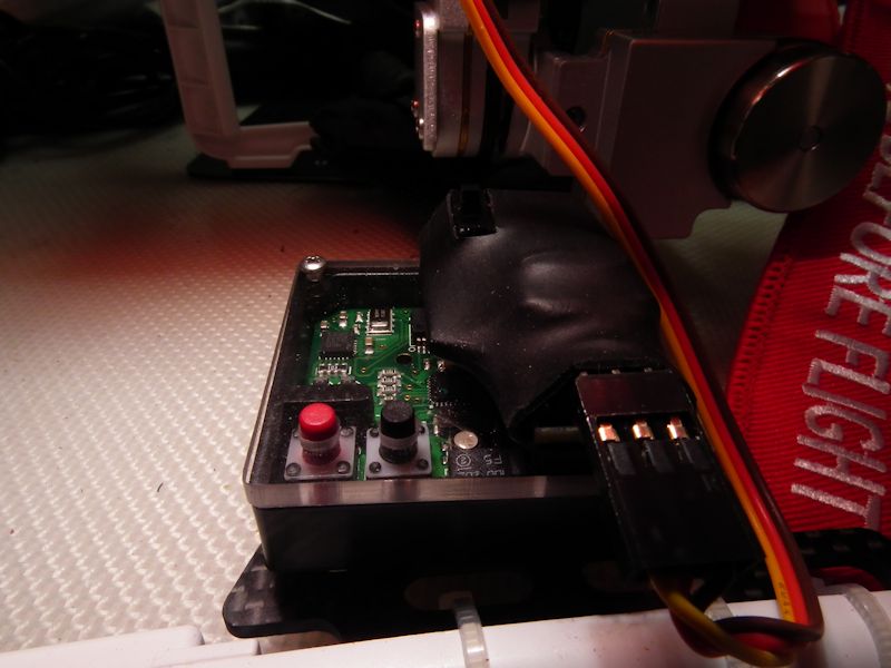

I like this new backPack, plugs in the Mayday and has an "on-off" switch, as ya see the servo than plugs into the batteryPack (also has a clear case cover now)

Ok everything mounted up. Firmware updated. Mayday servo endpoints set and Mayday calibrated correctly. So question, do you hear a tiny bit of servo chatter and see a little bit of flickering from the green led on the backpack battery when in the armed status?

From my use after 20-30min of testing, trying to get it to "trigger", I seen "green" led fickering on backPack, maybe just letting ya know it's on ?
(Tomorrow I'm going to hook the servo up to a rc receiver I have and set the servo in the middle of it's travel, then add the horn, than reset the "throws" on the mayday board) Servo should not buzz or jump in "set" or "deploy" mode, mine works OK, I just want a little more "throw" when it "deploys"
Reactions: Jbundy63

Well when I deal with things like this I tend to over think things perhaps. For example the Mars backpack modual is a single cell li-po. But the instructions state the Mayday takes a power input from 2.7v to 11.8v but servo output is set at 5v. You catch that? Wouldn't it make more sense to run a two cell li-po if it is supposed to send out 5v to the servo. Has anyone originally run a 2s then switched over to the backpack and noticed any difference in operation? Where is a Travis Pastrana style foam pit around here so I can just do a csc from altitude? Jeez.
Just another thing while I'm at it. I have three fully charged to discharged cycles through the backpack modual to where it self deployed due to low voltage I imagine. That being said I charged it all the way up and set a timer till low voltage deployment. I'm only getting just 40 minutes. Not the 60 to 90 approximate stated. Maybe another reason for me to get a small 2s li-po.
I see what your saying, I have a few of these that I'd like to try out, if you open that pack let us know what's inside besides the lipo, I may do that after a do some testing on battery
I want to see what's going on inside too.
