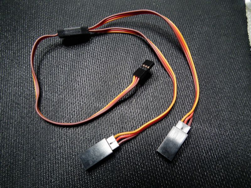

splitter or a Y, like this ?
Yeah that's what I'm waiting for plus the backpack. My splitter came in all jacked up, stepped on, smashed and in a hundred pieces, also the package was all taped up [emoji15]
