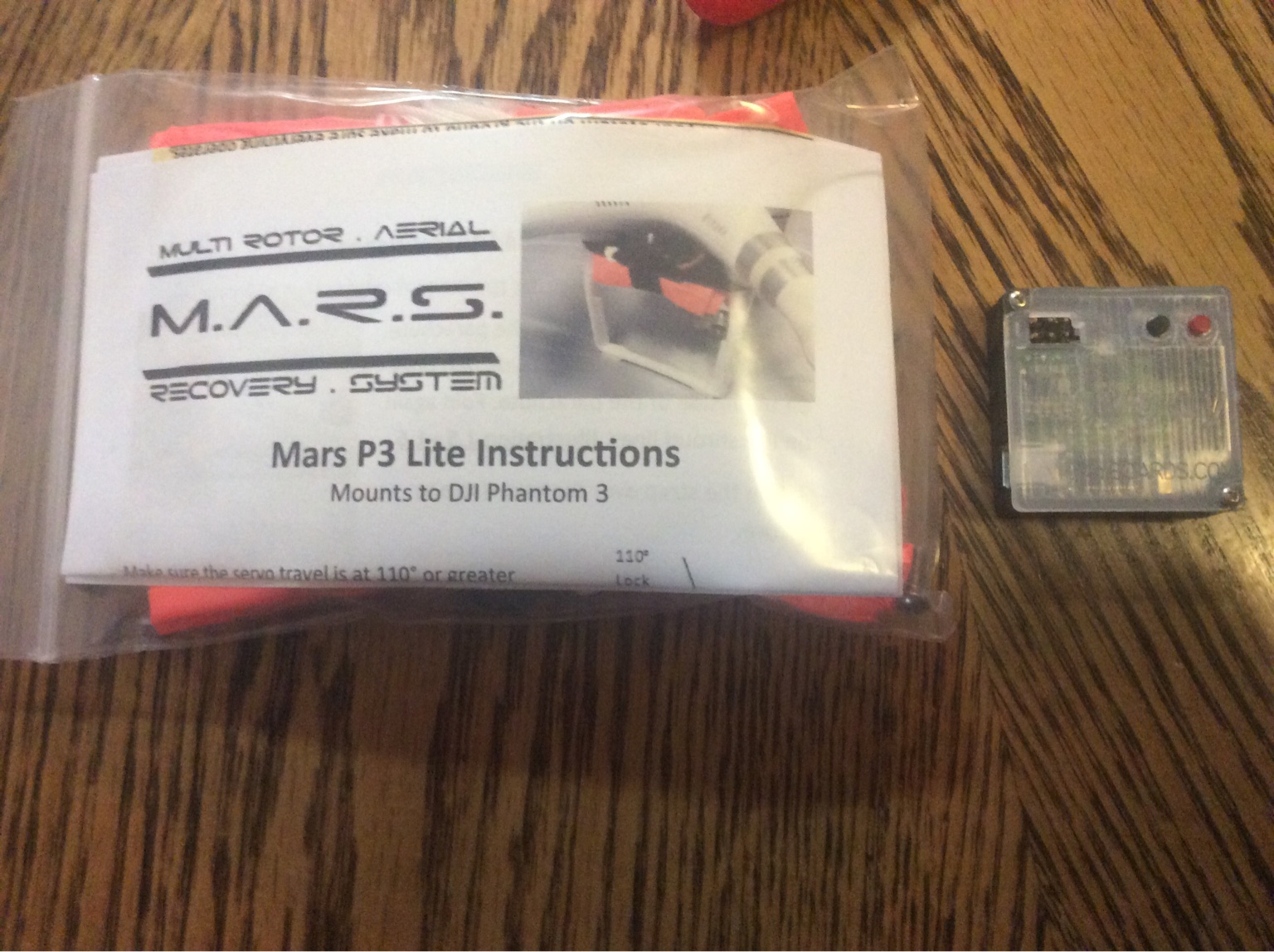

Just got my new kit. Anyone else purchase this or try it out?View attachment 38836
