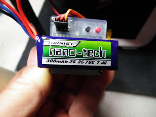

FYI
This Turnigy nano-tech 300mah 2S Battery, from a full charge, has been tested to power the Mayday for at least 8 hours with
3.77vdc per cell when I turned it off, the point ? You can run this power source all day without worrying about a charge, even longer than 8 hours if you want to discharge each cell down to 3.5 vdc, the total weight with wire/plug is 18grams

Good job Keith! Same here I have left mine on for over 6 hours and had plenty more to go. Mine is a little heavier due to it's 2 680 mah rated batteries.
