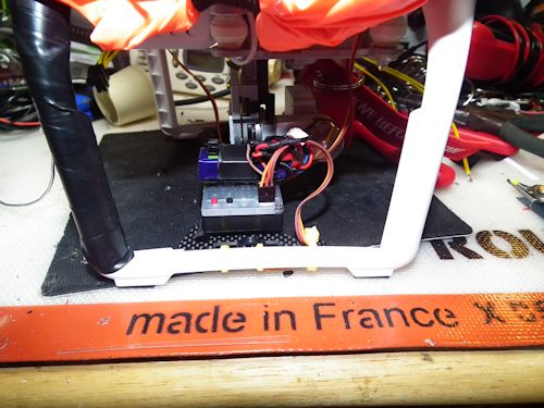

Mayday IMU ready for flight
Now 100% complete with 300mah 2s/switch

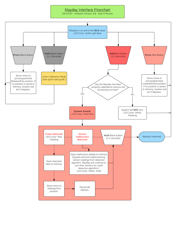

Nice flow chart so some may have a better idea on the setting/ indicator responses from the Mayday [emoji106]
Now that we've got this all wrapped up, go fly the hell out of it. I did at a lot of aggressive flying yesterday, not my normal flying and all went well. Just pray I will never need it and if I do, hopefully it will do me proud [emoji4]
