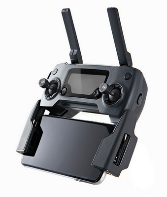

Mavic was released to work with GO app 3.0.0. Since Mavic DOES NOT have a dedicated RC controller, you use your tablet, pad, phone, flip phone, abacus to control the Mavic and the communication protocol is Wi-Fi and NOT light bridge as is for Phantom. Since DJI is *** bent to keep ALL the drones and OSMO on the same GO app (OSMO and Mavic work on Wi-Fi) there is an HD (video downlink) decode problem and you lose video. I found that by turning OFF the ENABLE HARDWARE DECODING will fix the video loss problem.
Really? I read the Mavic does have a controller, with ocu-sync, which appears to be better than lightbridge, based on specs, with less latency and more distance.
Wi-Fi operation is optional with your phone, with very limited range, likely 150' is my guess. Wi-Fi mode is mainly for selfies. If the OP was using it in Wi-Fi mode, this is operator error, you shouldn't expect more than 100 or 200' range, that's what I've heard anyway. Need to use the dedicated RC for good range, and flip it to RC mode.

Yes it has a hybrid controller that needs a phone to slip in for Wi-Fi communication (at least this what I was told by local dealer). By whatever means of drone communications it has, after the introduction of it and GO app 3.0.0 out P4 got screwed.
- New OcuSync transmission system offers up to 4.3 miles (7km) of transmission range.
(need to see specs and bandwidth to believe it. DJI can call it whatever they want, it still operates on Wi-Fi band)
- Fly by Phone over Wi-Fi for even easier flight
It shares the 2.4Ghz band with Wi-Fi users. It's important to differentiate DJI devices that are not Wi-Fi. Wi-Fi protocols take another 30 to 60 seconds to connect because of all of the tcpip handshake protocols. Lightbridge does not. I assume ocu-sync to be fast too, like Lightbridge. This is not only while on the ground, reconnecting while flying takes longer with Wi-Fi too, and often the video won't reconnect until you get the craft a lot closer, hence RTH is more common to get reconnected. This is exactly why I don't like Yuneec products. Been there, done that.
I really hate the new DJI GO app 3.0.0
Mavic doesn't have a dedicated controller? I think you need to do some fact checking, both on that statement, and your reference to comm protocol.
