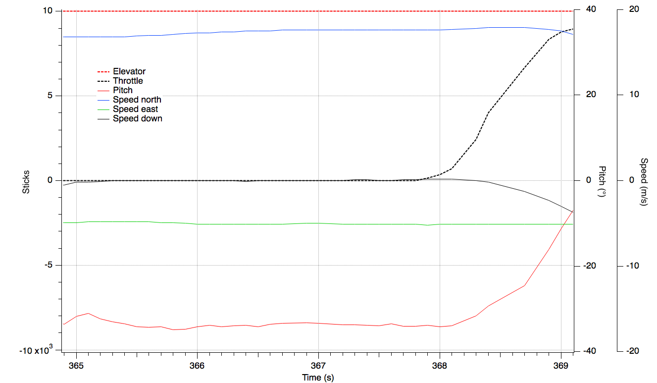

I'm a little suspicious that this event might have been due to a loss of power. There were some minor signal issues prior to the end of the log, but nothing that suggested an imminent disconnect. On the other hand, the end of the recorded flight coincides with a maneuver that caused a rapid and large change in aircraft pitch:
At 368 s the aircraft was flying in sport mode 18 m/s (40 mph) with full forward elevator, when the pilot applied nearly full throttle. As a result the pitch changed from -34° to -7° in one second, and was still rising when the log ended. That maneuver has, in the past, caused poorly secured batteries to disconnect/eject.
It's not conclusive at all but the coincidence of the maneuver with the abrupt end of the log is certainly suggestive.

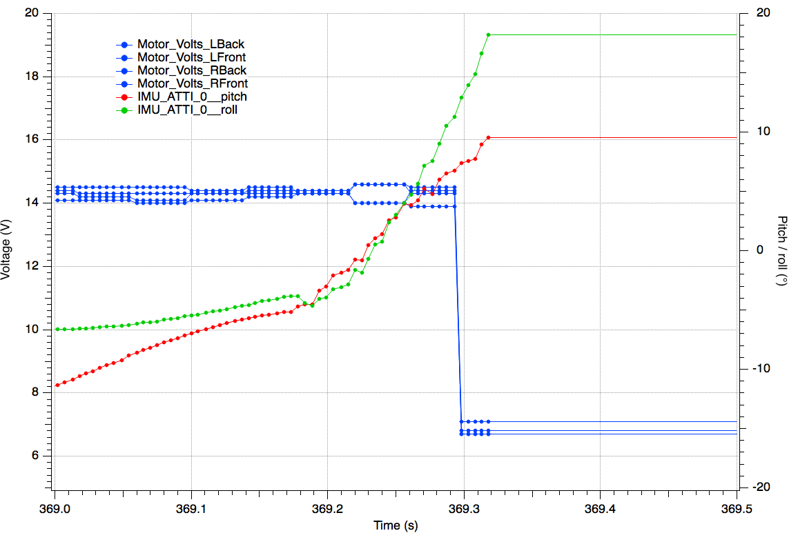

The recorded motor voltage does fall, but it does not look like previous power loss cases, where the inductance of the motor circuit slows the voltage drop at the motor. Here the voltage drops discontinuously from normal (~ 14 V) to around 6.7 V. Voltage and other data continue to be recorded for another 0.02 s. I'm not certain that these data are real, although clearly something did cause it to fall out of the sky at this point.
