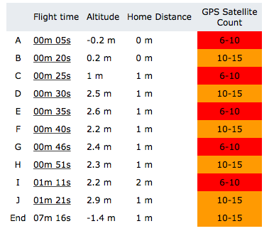

guys, I had a few days ago more or less the same issue : after 10 minutes flying I hovered the Phantom to think what I could manouvre next. Suddenly the Phantom started slowly landing.
Battery at 16%, distance 10 meters, hight 5 meters. Enough for 2 times RTH. The App showed me : communication loss. Took about 10 minutes to recover a communication. Around 200 Meters circle were no metall or radio equipments. The day before I did a RTH manually and automaticaly, as I am a newbee and have to train and get used to these things.
Nothing in my mind I made wrong. But that the Phantom did not made a RTH this time broke my trust.

Did you upload the flight data to healthydrones.com to analyze it? That is the first thing I would start with. It shows the path your Drone took until signal was lost and the strength of the GPS signal. It even shows the number of satellites being picked up. For example:
Red is bad, orange is good. You need to look at your flight data and see the GPS data.
My guess is you encountered a loss of controller signal at the same time there was a GPS loss. The Drone would not be able to RTH at this point. It would eventually land right below this last location.
It is a good tip - thanks ! I just registered at healthydrones.
Let me see if I can find the right data and I will upload it
