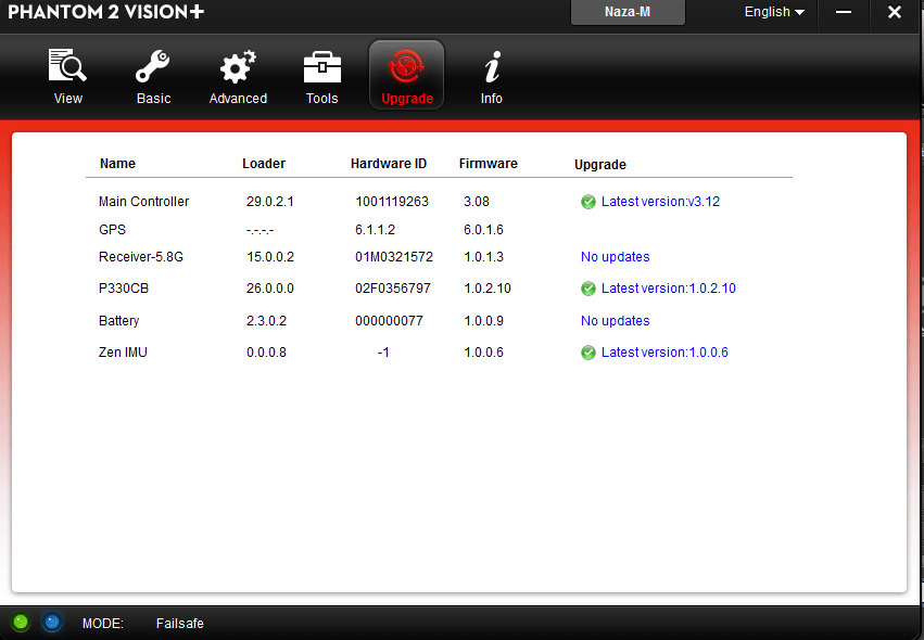

This was off the DJI website for the Vision+ software downloads, I only have Version 3.6, will need to update it I think
OK. I have downloaded the latest PT2 and it again states that the title for PT2 is for the "DJI Phantom 2 Vision" and not the Vision +. Which does make sense since in the control panel for the present PT2 under "Advanced" it has a set for "Gimbal" but the controls are for the "Phantom 2 Vision" and not the Vision +. Hmm
Every time I download the PT2 v3.8 I still get the "Phantom 2 Vision" and not the "Phantom 2 Vision+"

This is the screenshot of the "Updates" Gimbal firmware is still there, and the "Vision +" is there.
