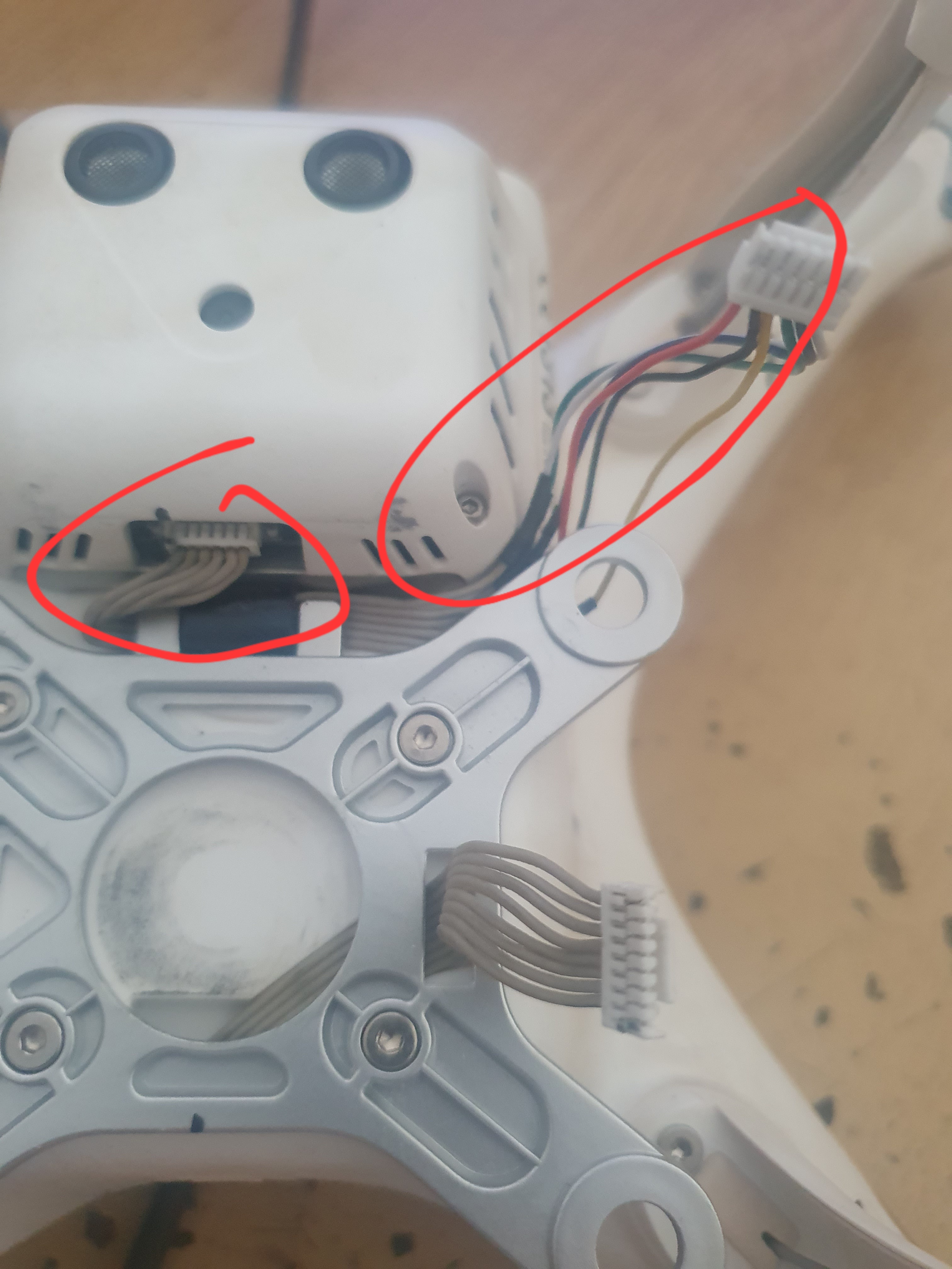

Thanks for lot replay, my drone is advanced,also camera is advanced,was ok but one day without touching firmware or whatever else when powered on was found as professional, and no image on my mobile at all,not even map, directions etc. Without visual on mobile drone can be flight. I would be grateful if someone own p3a and try to disconnect 2 connectors (see image) from gimbal to drone and power ON and see will be found as advanced or professional.As I remember now can't install any firmware, becouse sd card must be inserted in gimbal, so not know how goes this problem, gimbal operate,so could be bad camera flat cable its 2 of them but aliexpress one but was ok with first installed ribbon cable.

As I see also camera ribbon cable can trigger this error? Because I checked 2 connectors from drone to gimbal (one was loose so I asded cable) . But in my case also firnware update not going,no red/green led flashing...

Gimbal connects to the rest of the drone using 2 ribbons. One is from ESC Center Board, the other is from VPS.
Pinouts:
So there are two data links: USB and CAN. I am pretty sure all control data (in form of DUML packets) go over CAN, and the USB is for video only.
