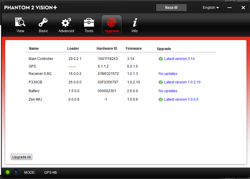

This is the screenshot of the "Updates" Gimbal firmware is still there, and the "Vision +" is there.
Thanks, unfortunately, even if I do the download & run on a PC(Windows Pro 7) or a Mac(OS X Yosemite V.10.10.3) all the attempts at downloading and running Phantom Assistant Version 3.8 result in the Phantom 2 Vision and not the Phantom 2 Vision +. So can't get to Gimbal firmware update which explains why after the last attempt to update the gimbal went dead.
