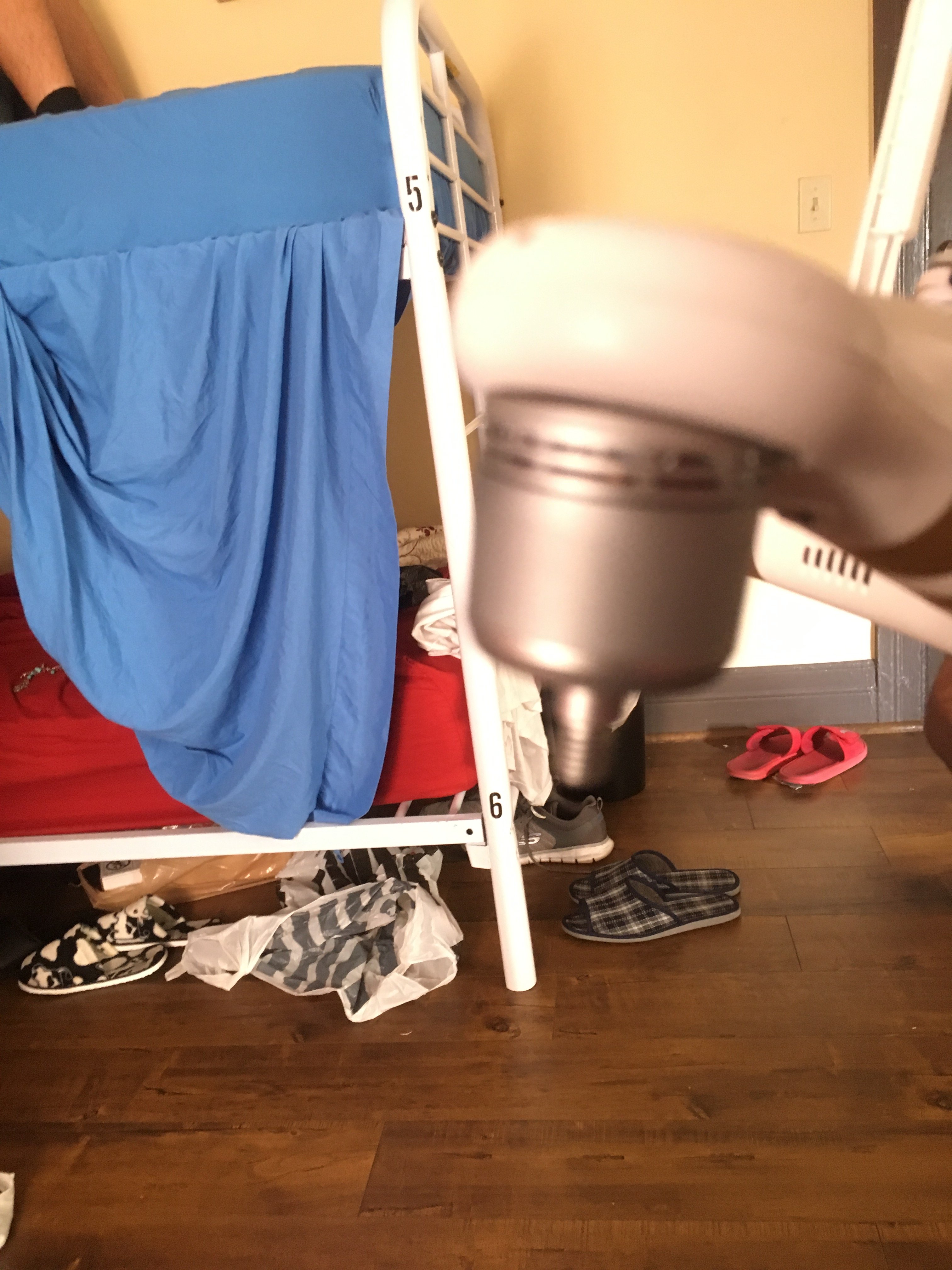

Hey all, newbie here. I just got a P3 pro from a private seller. Flies fine, tested flew it etc. when I got it home, I noticed this motor was loose. There isn’t any damage that I’ve seen. The other motors are secure in their base. Any ideas? Thanks!
Thanks! He had prop guards on it also, which I removed. It’s possible I knocked some screws loose in the process, because I had to use an Allen wrench to unscrew the guard mounts underneath the motor housing. Will look at it again after work to be sure.Welcome to the forum!

Well, that’s the thing. When I held the P3 upside down, only one motor seemed loose. I will check all 4 now.I was wondering the same. He said "The other motors are secure in their base," but also said that when he removed the props guards he, "just removed the mounts/screws, put them in a baggie and didn’t put any other screws in."

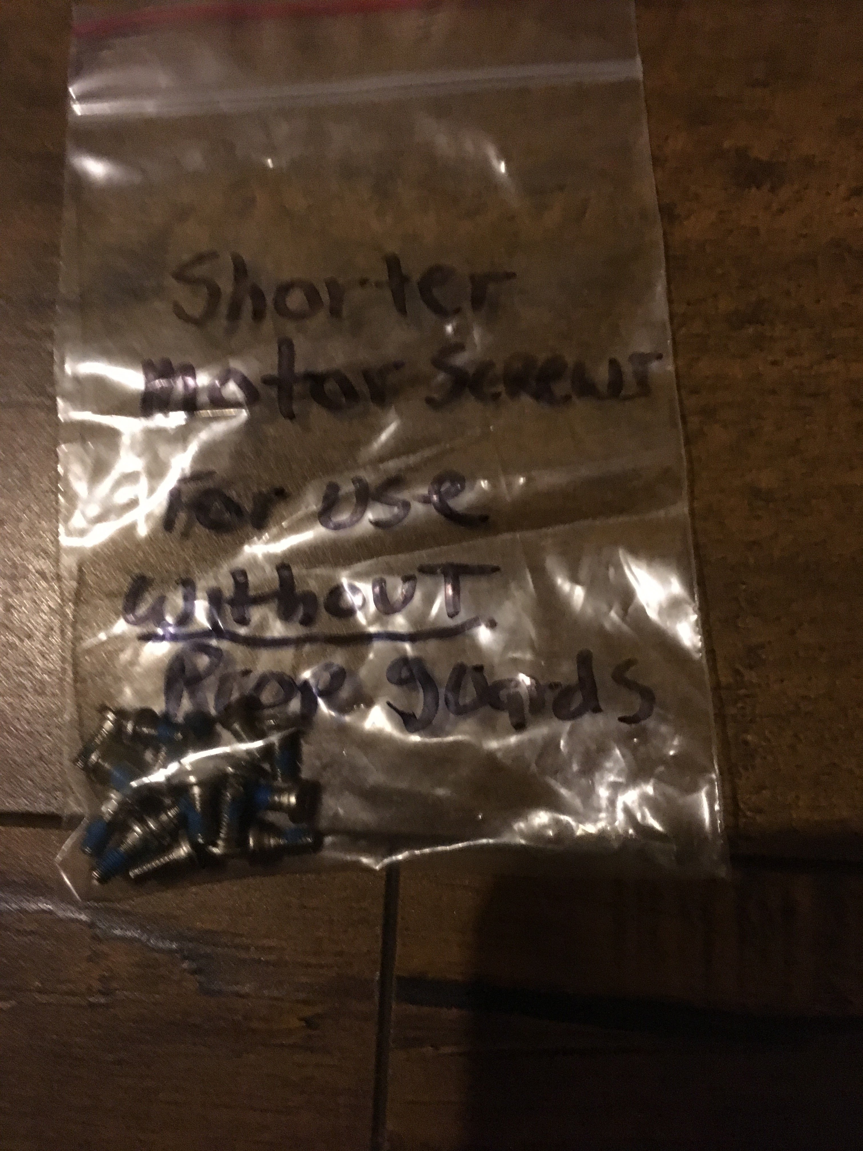

OMG, the guy took that much effort to label it. Maybe he made the long screw mistake himself.Look what found in the “goodie bag” that came with the drone.
Now I REALLY feel silly lol. I think I’m fine. I’ll put these screws on and see how it goes. Thanks for all the help.

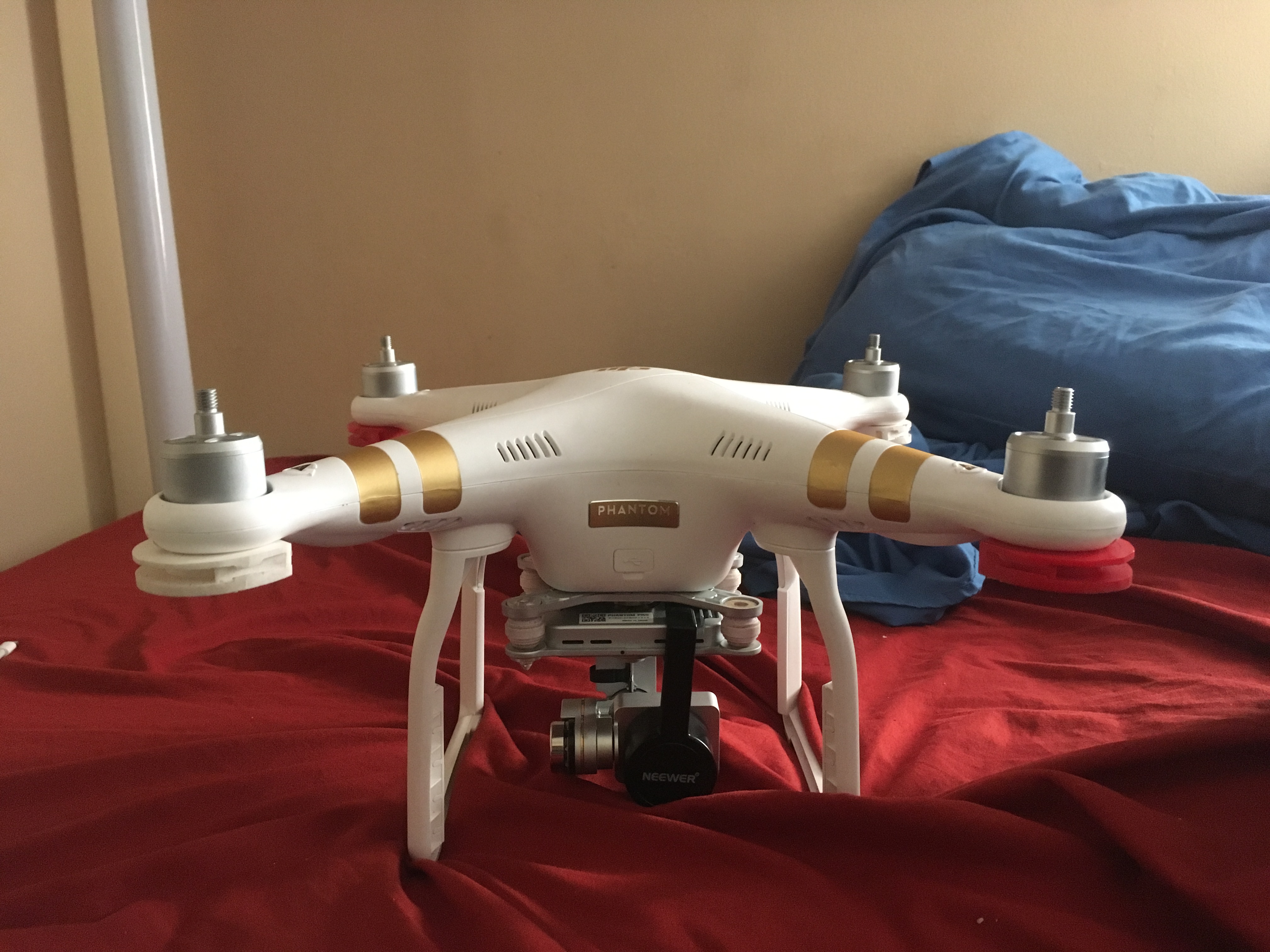

I went ahead and put the guard brackets back in. Everything seems ok, but I’m a little concerned the motors are in there slightly crooked. does anyone see that in this pic? Or are my eyes deceiving me?if they are removable prop guards consider this
