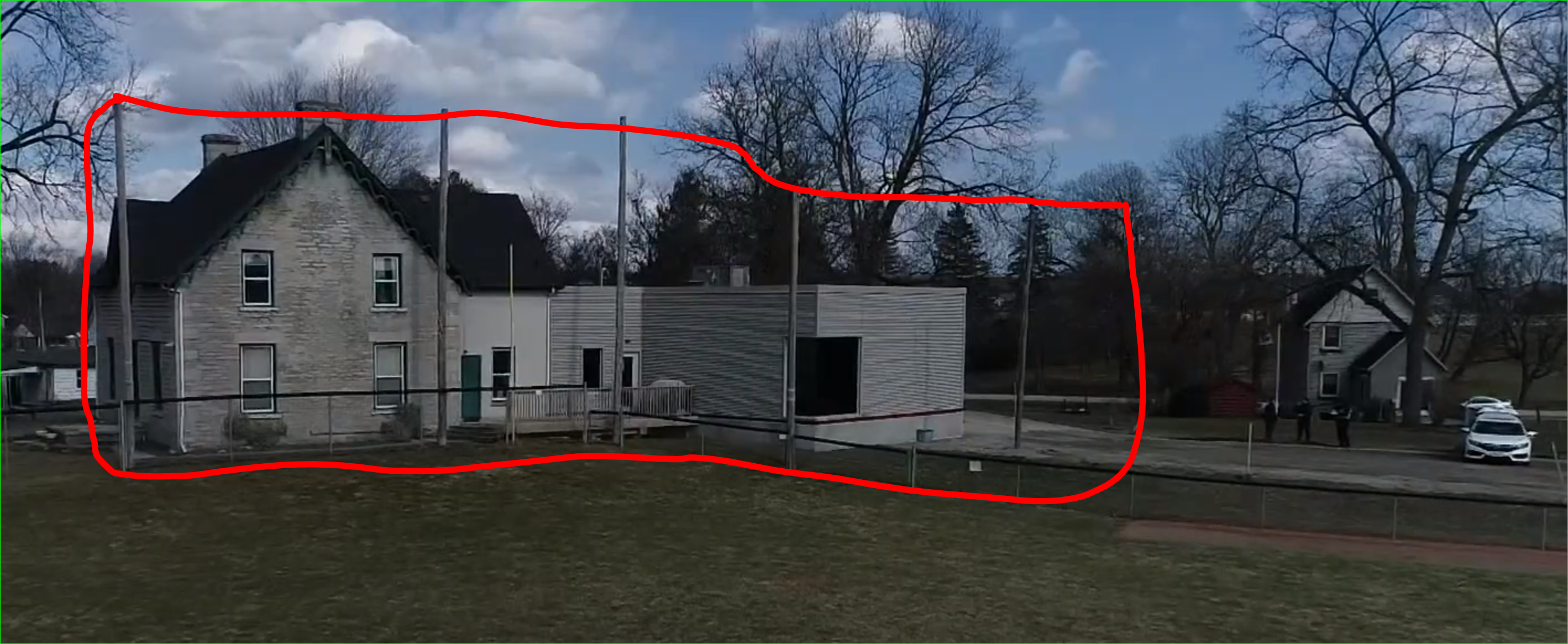

In this youtube video can someone explain why my video is reacting this way? Might be a setting???
I shot the video with these settings
I shot in 1080 standard, using an ND 8 filter at 120 fps
any help would be great
You sill see glitchy video around the windows plus the steel shed is flat but appears to have lines and color is added on final shot for some reason.

Seems like moiré to me.

You've got both moire and aliasing going on there. I don't know what you're flying or what camera, but the answer is going to be in your settings. I had a link to an excellent video that might help but it's gone. Search the forum and YouTube.
I would try slowing down the shutter (more motion blur) and reducing the sharpness in the profile setting you are using.

Aside from the fact that your sample is under-exposed, as others have pointed out, there is definitely moiré effect going on. I'm going to guess that there is a net hanging up here:
...which is causing your moiré. This may be exasperated by your exposure and/or rendering codec. I see a lot of digital artifacts in your sample. You said you shot this in 1080p, but it looks like it was shot in 4K and then down-resed to 1080p. Are you SURE you shot it in 1080p???
Unfortunately, there's no way to eliminate moiré. You can only try to reduce it by either shooting lower resolution (1080p instead of 4K), reduce sharpening in your camera, softening the footage in post or taking down that net that's set up in front of the house.

It's likely that there's nothing wrong with your camera at all and the issue is due to a combination of moire and compression artifacts.
Test the camera by shooting something else without fine lines or a net and see how it works.
And unless you have a particular reason for shooting at 120 fps, use a slower frame rate, eg 30fps.

It might appear that there is a net but there is none. I had this happen on many different shots at different exposures.

I have done another test using log and a variety of frame rates. Please check it out.
First of all, thank you to each of you who have given your input. Since that initial sample, I have reset the drone to factory settings and re-calibrated it. I was hoping this would show better results but I don't think it does.
The first set of shots are directly from the raw log record then a quick color on the second set. I can see the issue in both sets. I do find though that by lowering the sharpening it does help but compromises the video. Also, I do see a 'jelly' effect in some of the shots as well.
Any input would be greatly appreciated.
