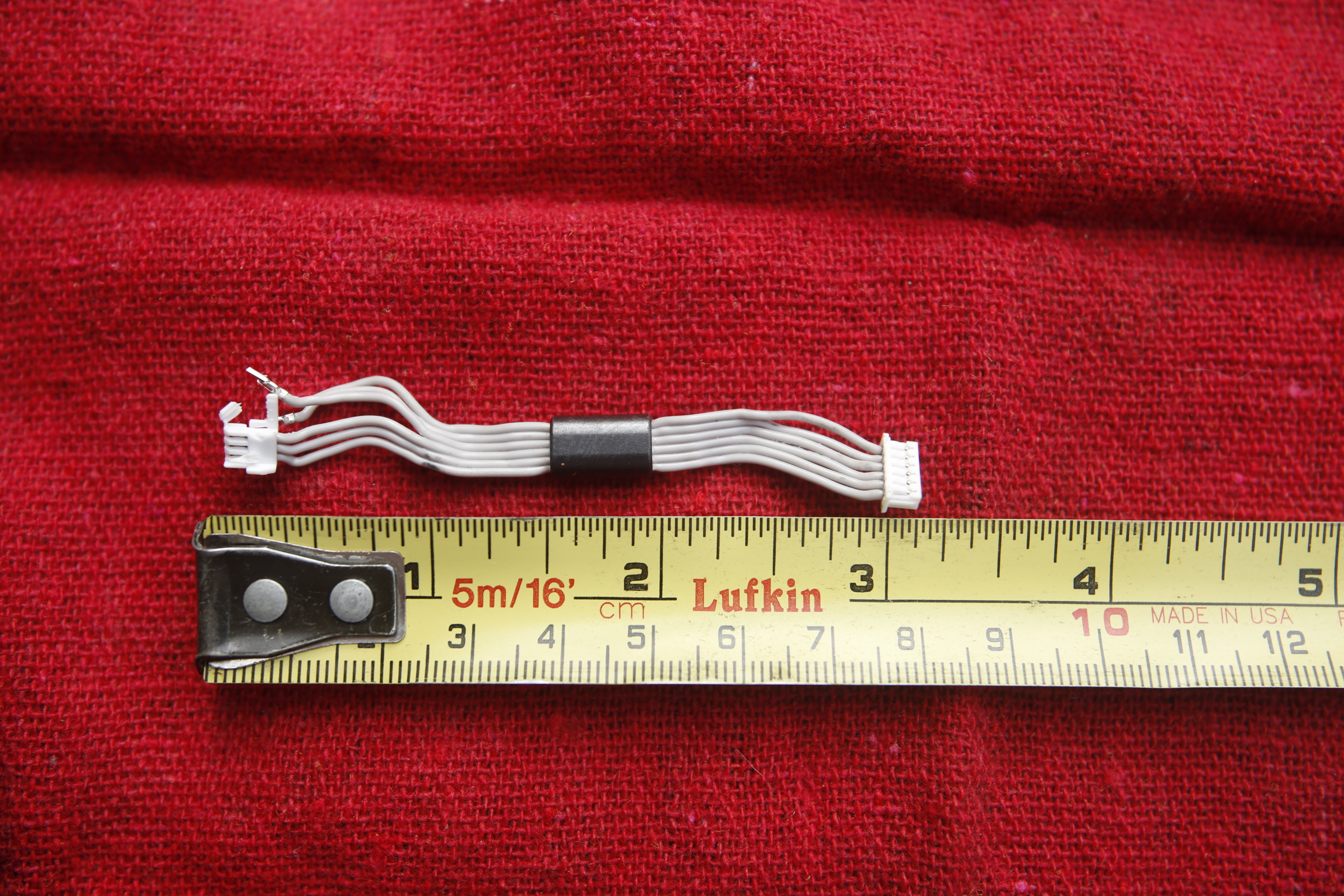

Here's a quick update on finding a replacement cable. The search appears to have been successful. I ordered a 6-pin gimbal cable from Aliexpress on 6-20-21 and it arrived on 6-30-21...much faster than I expected from China. The total cost was $7.50. It's shorter than the DJI cable...but it works. The two ends are different, just like the DJI cable. One end has a small clip and one end is a friction fit. The friction fit end would not slide into the female plug at first. So I compared the DJI and Ali ends under magnification and found the Ali cable end had a small ridge across the front of it making it larger than the DJI end. I made a few passes over the ridge with a small, fine file and then it plugged right into the female circut. The next step was to check for camera control of the gimbal and to see if I had video to my tablet. I had both. So I'm pretty pleased that this shot in the dark of ordering something from China worked. Here's a photo of the two cables side by side.
