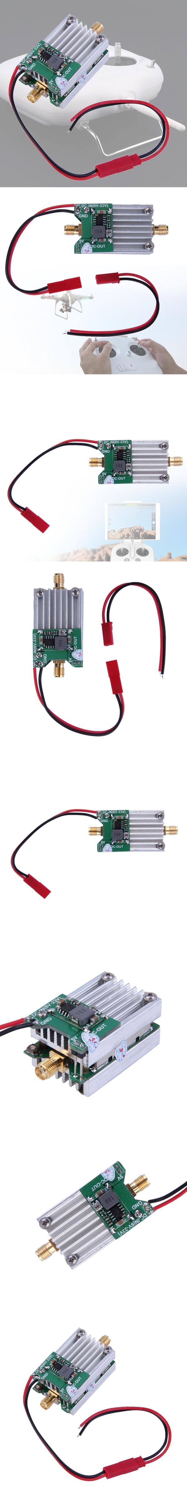

The standard is extremely simple to boost once an antenna rail has been fitted ... either Argtek or Itelite. The rail is needed unless you fit tails to the RF connectors internally and mount to case.
2W boosters for 2.4Ghz are cheap as chips ... can even run of the rc battery if necessary ... but of course that will mean shorter RC battery run time.
Here's mine I did back in summer 2017 ...
It also has the 5.8Ghz booster - but actually that's not really needed if you use the Windsurfer ...
This 2.4GHz will give steady and good video / telemetry range of over 5kms on the standard ...
2.4G Signal Booster Amplifier Antenna For DJI Phantom FPV Transmitter Receiver | eBay
It can only take 5V though -so either an RC BEC of 5V running of a 2S LiFe / LiPo or a 4 cell NiMh pack ...
If you fit the 5.8Ghz booster as in my photo - that can take power direct from a 2S LiFe pack and also cheap as chips ...
5.8Ghz FPV Transmitter RF Signal Amplifier amp For DJI RC Airplane Helicopter BG | eBay
