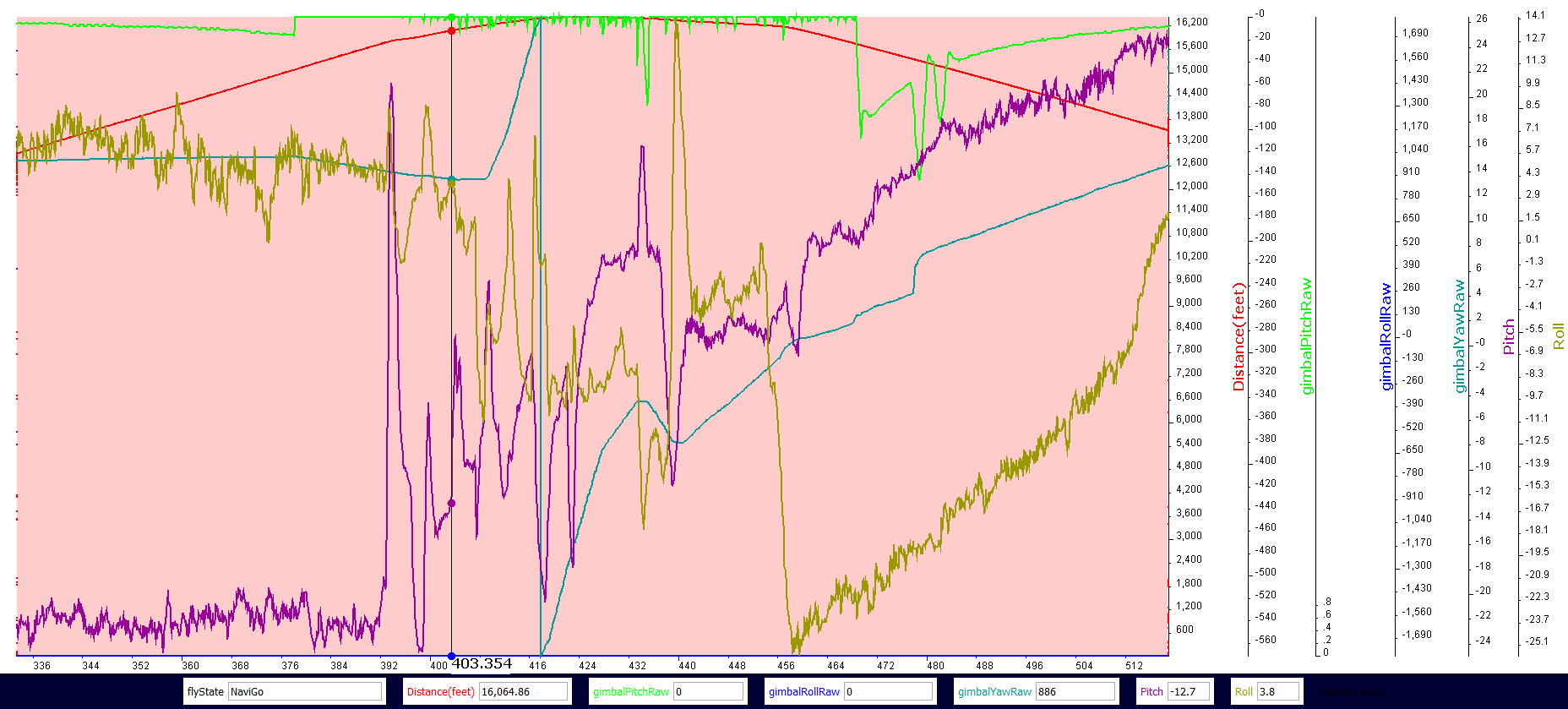

I performed a basic look at the log with the phantomhelp log viewer but saw nothing indicative. Maybe the experts can look deeper? I’d appreciate it.

I tend to agree. The aircraft was pitching up/Down and Rolling Left/Right. The gimbal was attempting to correct for the angle differences.

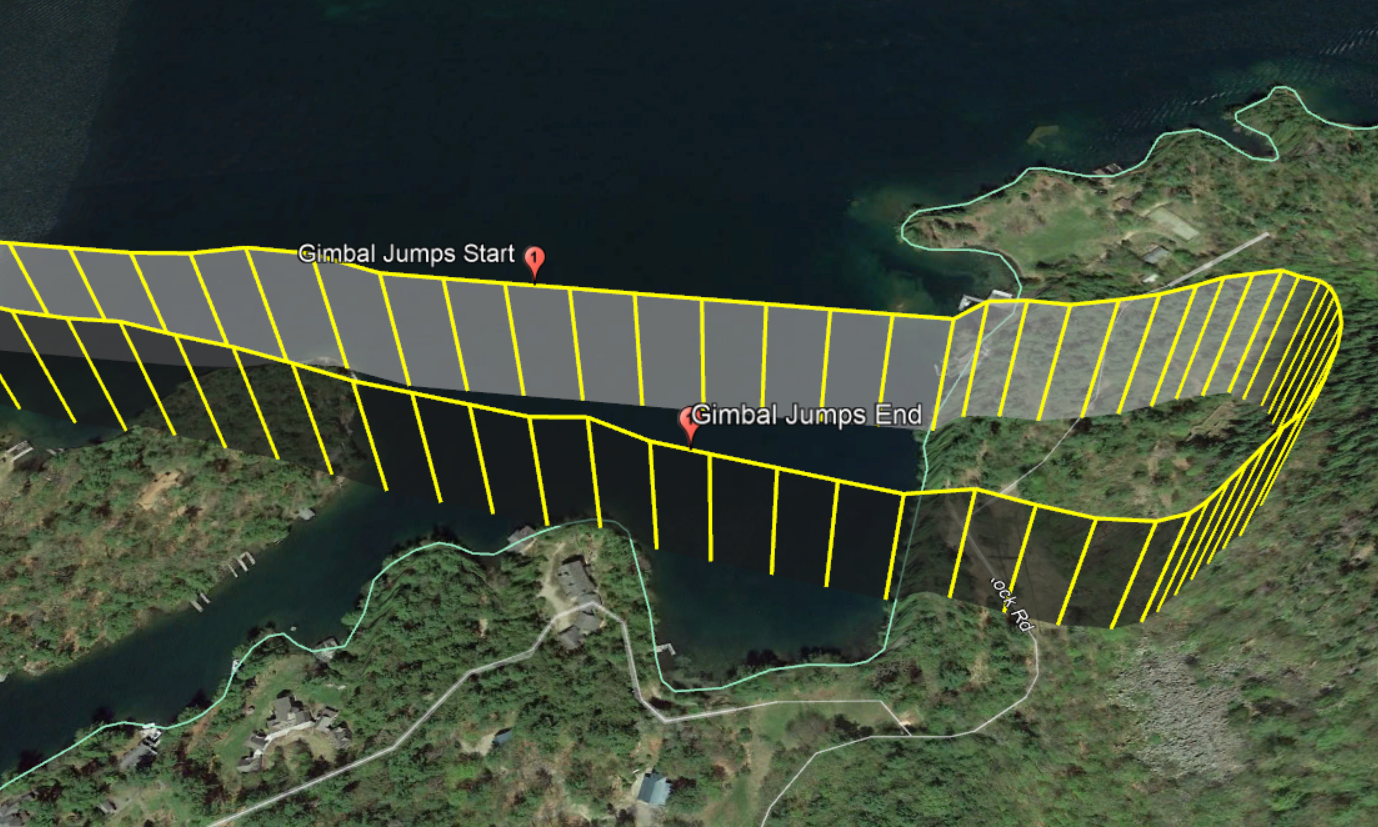

@bsartist Just out of curiosity, I took a closer look at the turbulant spots in this flight. Surprisingly enough, they began and ended very close to the same area. Ingoing and outgoing. That would suggest where the turbulance was.
Interesting. Further from the face of the mountain than I thought. But I suspect the turbulence from wind coming over the mountain/cliff can reach out pretty far.
