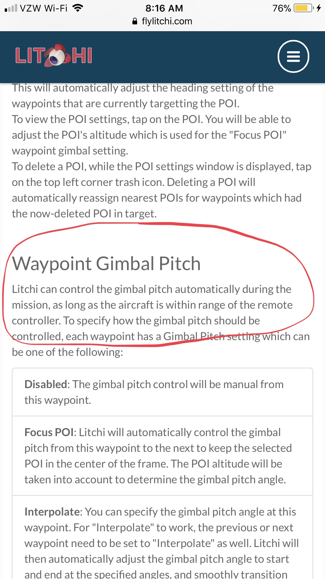

Help - Litchi
Within the link above it states...
The Litchi “APP” controls those functions. If signal is lost they won’t work.

The proof is in the manual. The fact your commands still worked with your android device just proves that you didn’t lose complete signal. You said “periodically “ not completely. A video glitch is not complete loss. Most of us lose video but can use control to raise elevation to get video back. The Litchi commands are sent through the TX side of the remote to the AC so a periodic loss of video will not cancel mission commands unless TX is also lost.
Also, at one point I was hearing so many different opinions on this same subject, plus I was building my mods at the time so I bought a meter to find out these questions myself and though the meter isn’t a high end meter I believe it was good enough to answer questions I had with this subject being one of them and I can tell you from testing with a meter that the power of the TX signal does not change by switching devices. RX can however be affected by the processing speed of each device and by how well you have optimized that device for flight. Msinger has a great thread for optimizing iOS devices.
