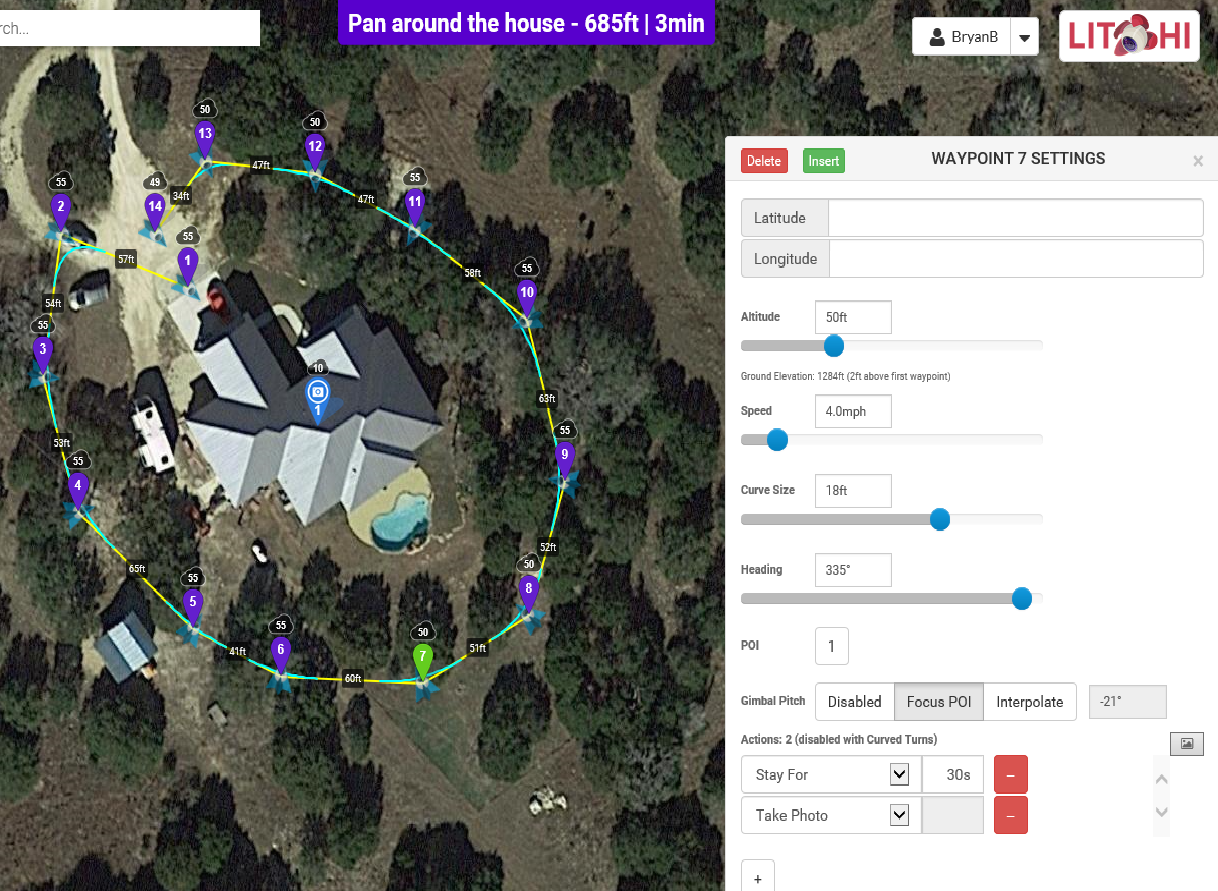

You can setup a mission to do that in the mission hub. you can set a POI and how many feet off the ground for the camera to focus on then at each waypoint you stop for so long and take a picture.
Reactions: Pharm
see the waypoint setting at the bottom. I stop for 30s then take a photo. the camera is looking at POI #1
I'm curious about this... It looks like you're using curved turns instead of straight lines as your path mode, and I thought waypoint actions cannot execute when using curves. Is this what you're doing? Is so, how did you get it to stop for 30s and take a photo?
Uh, add two way points with no turn, click - ahhhh.
