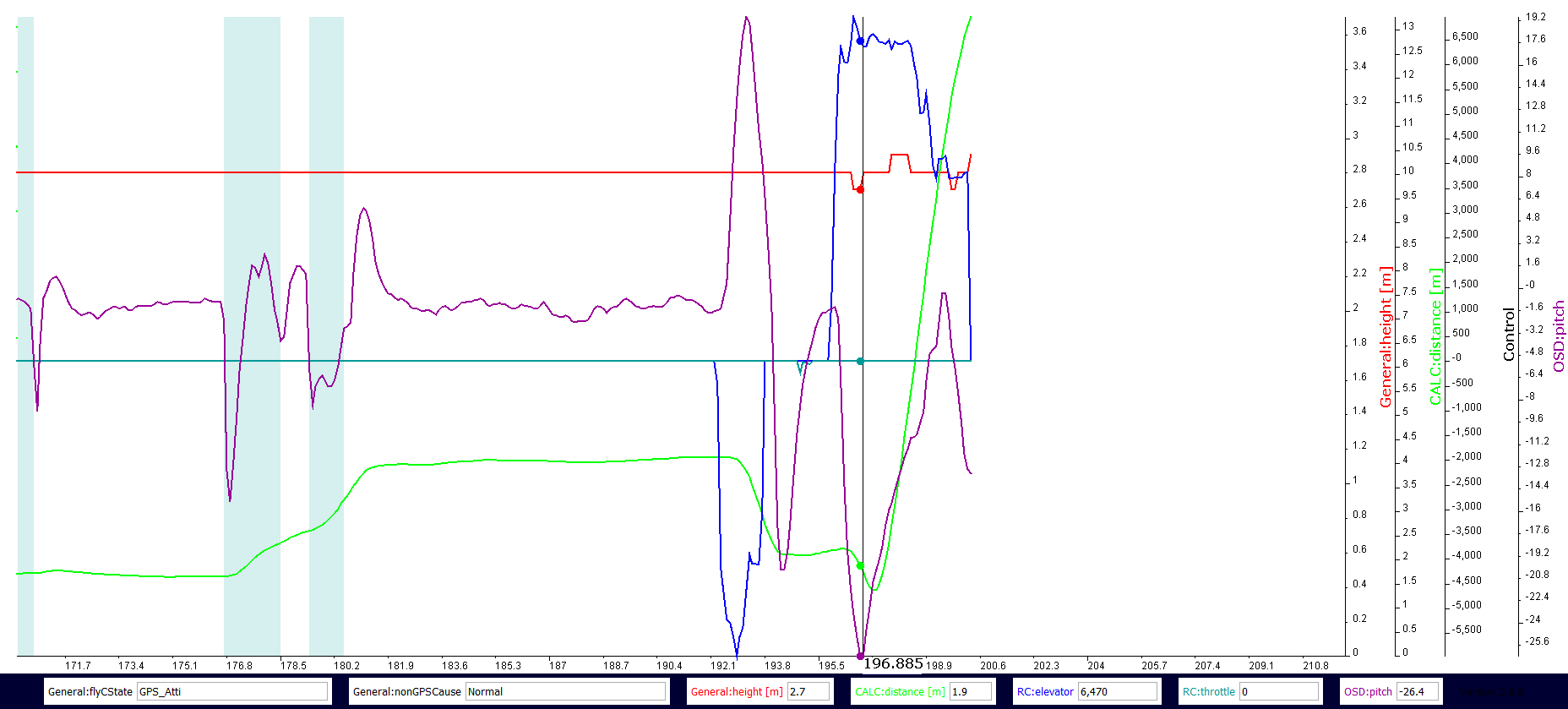

Ok folks. This is where I could really use some help from experience or knowledge. I have a phantom 4 pro. Today went for a quick flight in the back yard. Hovered for a while testing the gps. Had 11 sats, flew forward about 20 feet (no obstruction from sky or gps) when I let go of the stick, the drone lost all power and fell straight out of the sky, breaking the right leg off and cracked the glass on the uv filter. Admittedly, it was an aftermarket battery. But I’ve flown it many times on that battery. Thank God it was only 15 feet altitude. Even after t crashed, it turned right back on (of course I didn’t fly it again, but I wanted to test the camera, props, etc.). Is there something I should be looking for, that would have caused this?
Assuming the aircraft didn't lose all power, upload your device log to the link below and share a link back here and we can give it a look see. Log Viewer I have a suspicion however that it could have been an improperly seated battery. This issue has been around a long time with P4's.

but the log shows nothing about loss of altitude, or travel slow down.
Altitude no, travel slow down yes. This as stated before looks like an improperly seated battery, accentuated with hard braking. There was no CSC.
That is awesome! At least I have an answer! Thank you! Now I won’t have the fear of taking it up again. Now, the battery was locked in tight, even after it hit the ground. Could it be a faulty battery?
It's anyone's guess whether or not the battery may have re-seated itself upon impact. It's possible, but my gut reaction is the battery failed.

Being a manager of a forklift dealership (and many forklifts are electric), I sent the battery to one of our vendors who tested it. Under load, one or more of the banks totally dropped out, and had a total power failure. So my hard brake and reverse made the new (aftermarket) battery completely shut down and turn off the phantom. But then turned right on again after the load was gone. It only dropped out in a hard load. But taking off was a gradual load. Trying to exchange the battery now.
