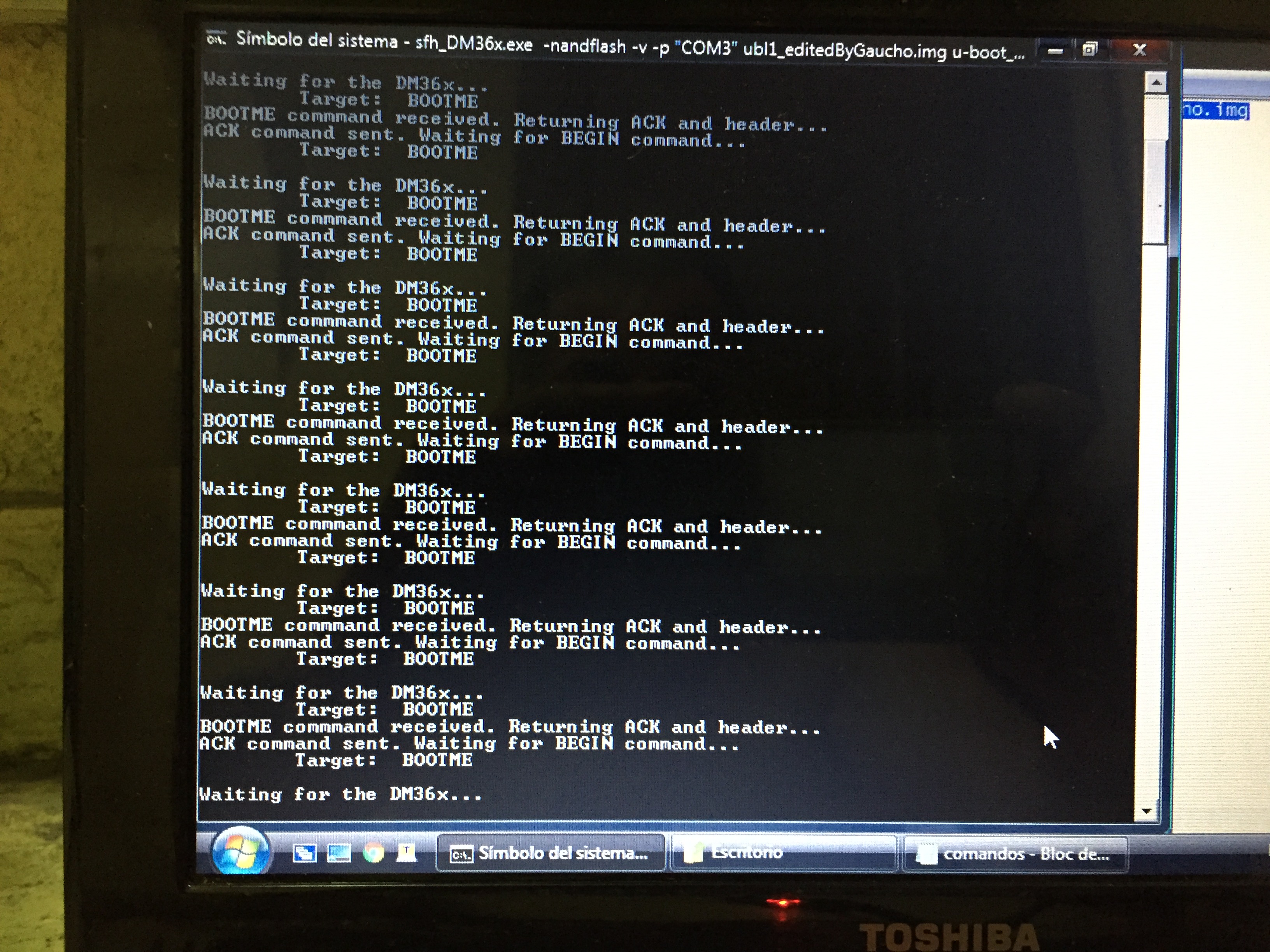

Hello, sorry, I have a problem in my P2V+, I have done all the steps but when I entered the command the screen does not pass from ...
waiting for the DM36x...
Target: BOOTME
BOOTME Command received.returning ACK and header...
ACK command sent. Waiting for BEGIN command
Target: BOOTME
CAN ANYBODY HELP ME? PLEASE

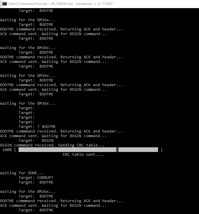

Mabe try to erase NAND first:
sfh_DM36x.exe -nanderase -v -p "COM10"
(insert proper COM number instead of "COM10"
It helped to me.

thank you for responding, and try to delete the NAND with that command (in my case the assigned port is COM3), try several times with CTRL + C but always stay on the same screen
Many thanks to the topic starter, the method works!

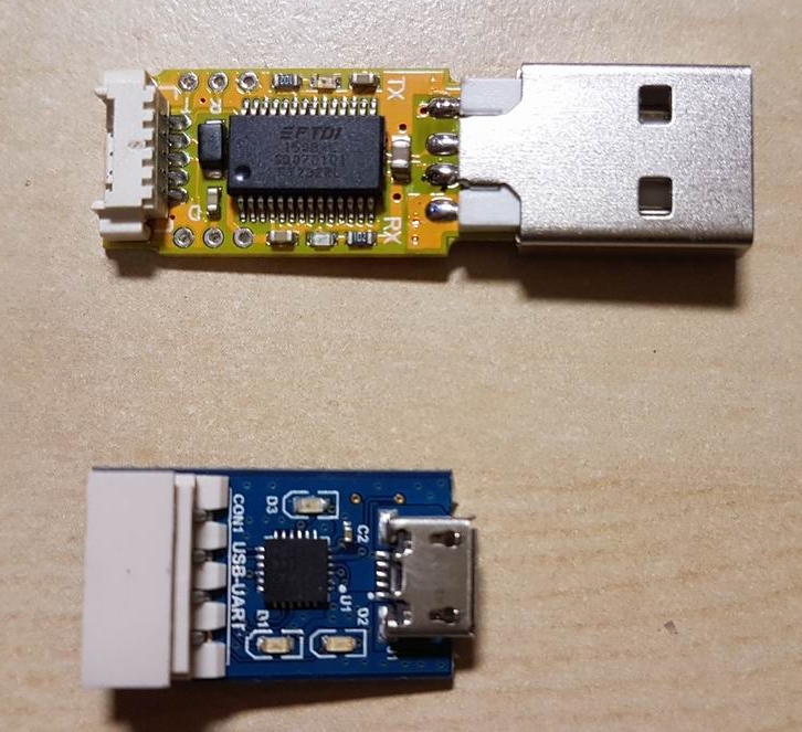

I had the same situation, but with the lightbridge 1 ground station .
I tried to download the firmware using two different USB-Serial adapters that I have.
One from ODROID (blue), the second one bought ftom hobbyking for flight controllers (see photo).
With blue one it was the same as you - utility see BOOTME request but no reaction on ACK from the pacient.
With yellow one everything was immediately started loading and in the end it all worked!
I didn't erase flash.
Blue as far as I know with the levels of 1.8-3.3 V, yellow, i think 3.3-5 V. Maybe the problem is in the adapter (signal levels or something else).
