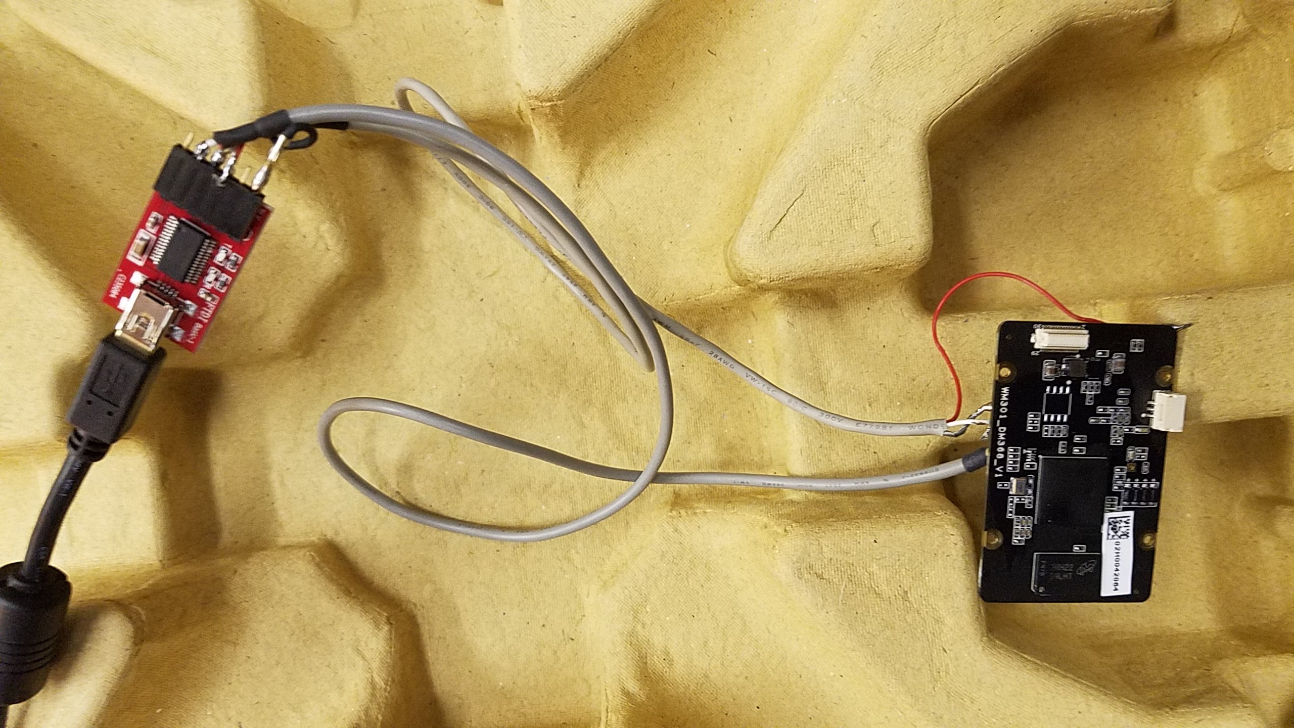

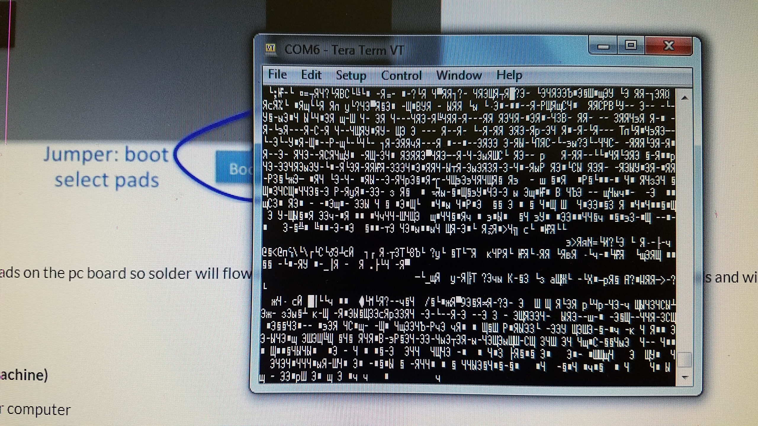

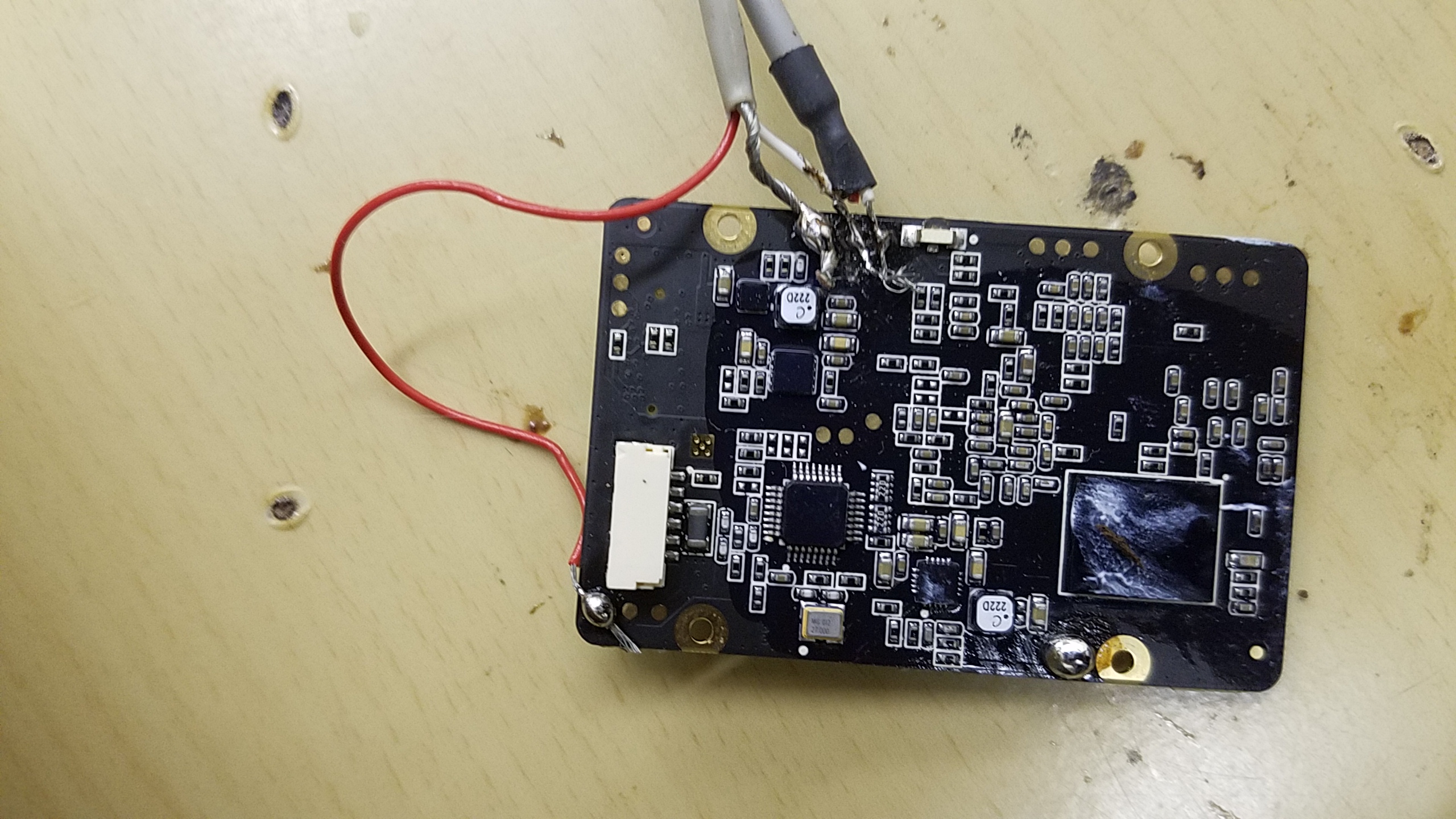

Please could someone perhaps help me out with a full NAND dump from a WM301_DM368_V1 WiFi module... Managed to get a kernel on but not booting properly. Thanks in advance!
Ok I am stuck.. I think my board it not booting. I'm not getting "boot me boot me boot me" message. Instead, I AM getting a whole string of characters, like arabic/machine language/unintelligible strings in my terminal window right after I connect in the exact proper order the board to the adapter. This goes on for a couple minutes, pausing once in a while and red blinking light once in a while when it seems to be dumping a whole bunch of data. So I've waited until it finished before closing Tera Term. I can connect, disconnect no problem. So then I exit Tera Term and run in command prompt, message I get is:
TI Serial Flasher Host Program for DM36x
(C) 2009, Texas Instruments, Inc.
Ver. 1.50
Flashing NAND with dm6467_297_ubl.img and u-boot_modifiedByGaucho.img.
Attempting to connect to device COM6...
Press any key to end this program at any time.
Waiting for the DM36x...
Help?
Ver. 1.50
Help?

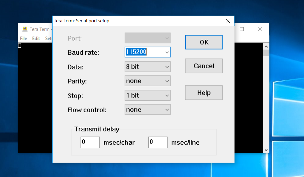

Have you set the port up correctly in the terminal you are using? 115200, 8 data bits, 1 stop, no parity...?
Yes. I did. I have also tried it at 9600 baud since my port in Device Manager, that was the default.. Tried it at both speeds more than once at each with no change.
I did take it out for a flight today and did alright with no FPV but will be glad to get the video back.
When you say in device manager, is that where you are making the changes? The port setup should be done in the terminal app you are using, not device manager...
No. I adjusted my port settings in my Windows configuration to allow speeds up to 115200+ (setting suggested in instructions).. The default setting was 9600. Then I used 115200 in Tera Term. I figured what point would it be to try and use 115200 if the port is only set at 9600? At any rate.. it made no difference. I tried at 115200, and 9600 just to be sure. Tried 115200 in Tera Term and only the default of 9600 in my Windows Device Manager.
Did you set parity to none, Stop bits to one and data bits to 8? If so, could you maybe upload a high res image of your board as well as your serial adapter? Can also disconnect everything and short the tx and rx pins on your adapter ther send anything in the terminal and make sure it receives it.
Yes, I followed the instructions; parity none, no stop bits, and 8 bit.. These are only photos I have. It's back together and flying blind for now... This was my first soldering job, before I cleaned it up a bit. I trimmed the excess wire before attempting. I tried twice soldering, in case I didn't have good connection.
Thanks for taking an interest.
I had a look at your pics, can't really see what's going on there, so not really in a position to say if it's correct or not. Just make sure TX on the wifi module goes to RX on the serial adapter and vice versa.
As for your reply about port settings, i see you said "no stop bits", I'm not sure if this was a typo or not but the stop bits needs to be set to ONE. You can see my port settings below.
As for your reply about port settings, i see you said "no stop bits", I'm not sure if this was a typo or not but the stop bits needs to be set to ONE. You can see my port settings below. View attachment 90907
Ah yep, typo.. "8n1"... "n" standing for "no parity." Sorry, was confused when posting. Did it correctly though.
