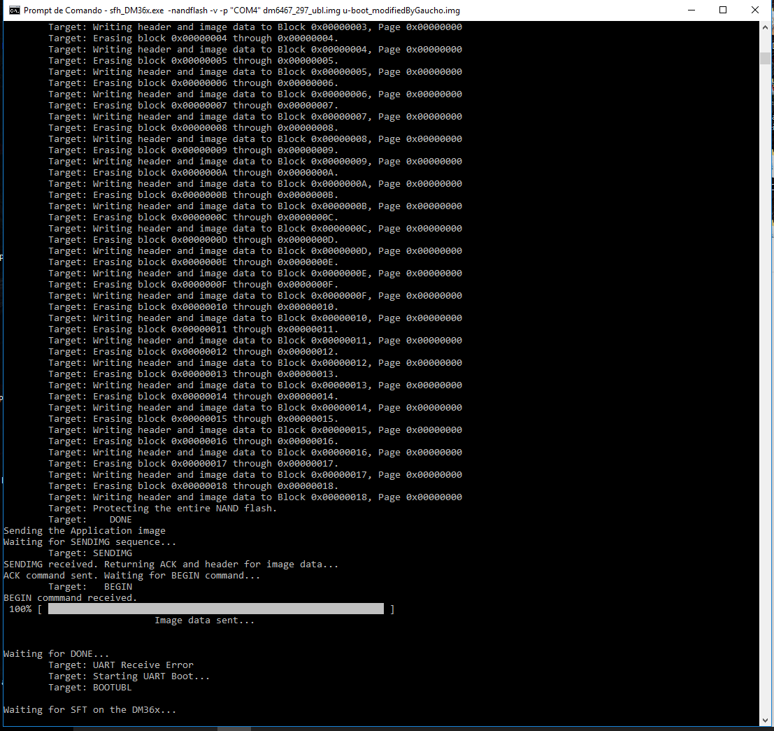

Any ideas as to what couple be causing this error

OK so first atemot failed. the usb to tll works great BUT!: when I enter this: sfh_DM36x.exe -nandflash -v -p "COM9" ubl1_editedByGaucho.img u-boot_modifiedByGaucho.img
it says: it never says target: BOTTME??? what did I do wrong here?
DM36x initialization passed!
UBL Product Vesion : DJI-ABP-SUPER-UBL-1.0-rc0(2014-08-25)
Dji UBL Version: 1.51(Aug 26 2014 - 16:00:24)
Booting Catalog Boot Loader
BootMode = NAND
Starting NAND Copy...
Valid magicnum, 0xA1ACED66, found in block 0x00000019.
Valid magicnum, 0xA1ACED66, found in block 0x0000001B.
Valid magicnum, 0xA1ACED66, found in block 0x0000001D.
Valid magicnum, 0xA1ACED66, found in block 0x0000001F.
No valid boot image found!
NAND Boot failed.
Aborting...
Hi, how did you solve this problem? I have the same, i switch over tx, rx in the ft232 board but it doesnt respond in such way.

can someone help me in my phantom 2 more this giving this error of the image.
And enter into an infinite loop. (repeat again).
HELP !!!
The message says it all - you have UART transmission issues. Make sure:
- You're using 3.3V FTDI
- Your cables are good quality and not too long
- Everything is soldered strong,
- all connectors have good contact
- Cables don't move while flashing is in progress
Also try using different FTDI and cables.

I always have uart receive error, but am able to flash anyways. Might be better with other ftdi etc, but for me the key was winxp 32 bit! /carl
After numerous attempts, and never getting, "BOOT ME", I figured out that in my case I had to deviate from the instructions a bit. The ONLY way I got into the boot loop to be able to proceed, was to have the 3.3 jumper in place, the wifi board connected to the serial-usb adapter, and THEN plug into my laptop, start Terra Term, set the port and speed, and there it was, "BOOT ME". I did have to flash using steps 9 & 10 before I got everything to take. And even then, the step 4 confirmation shows failures, but it works! I've got video again! WOOHOO!
