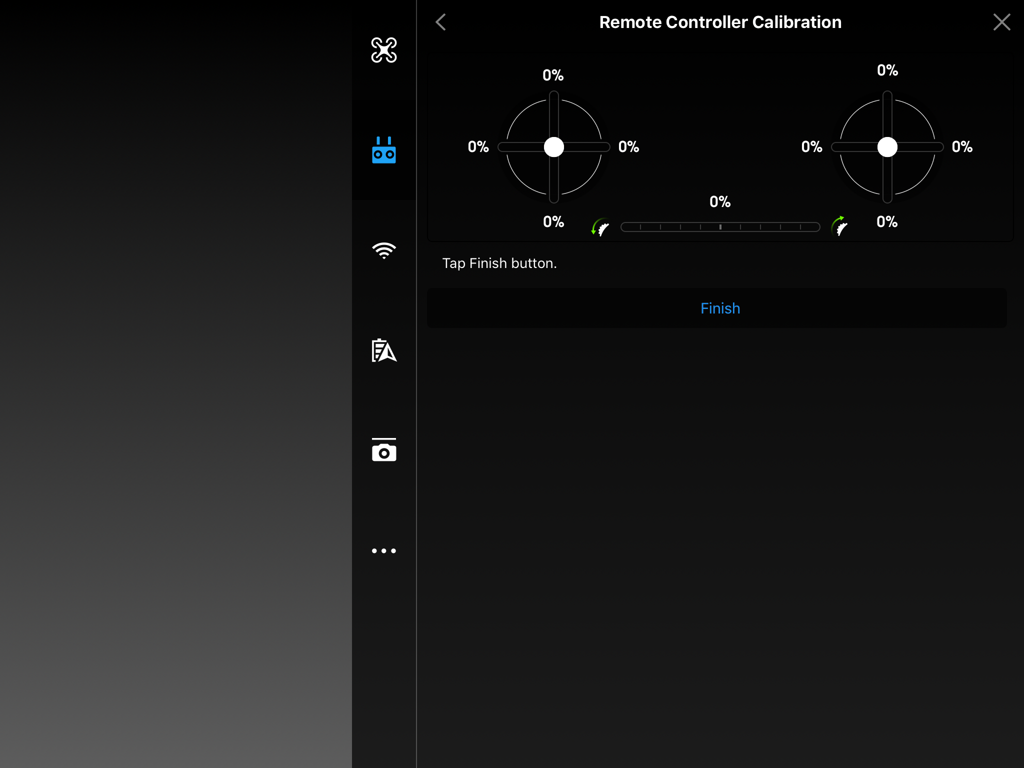

    Thanks for the video I have followed this but whenever I press start of the calibration it asks me to put the sticks in the midpoint which they already are when I press start again I get the same messag

    When you press start move the sticks and wheel then hit finish . Not sure why your hitting start twice Camp ..

    Just did mine
    From this 1.PNG then this 2.PNG I press start and get this 33.PNG I press ok then do all the motions
    and then see finish which I press 4.PNG and that's it .
