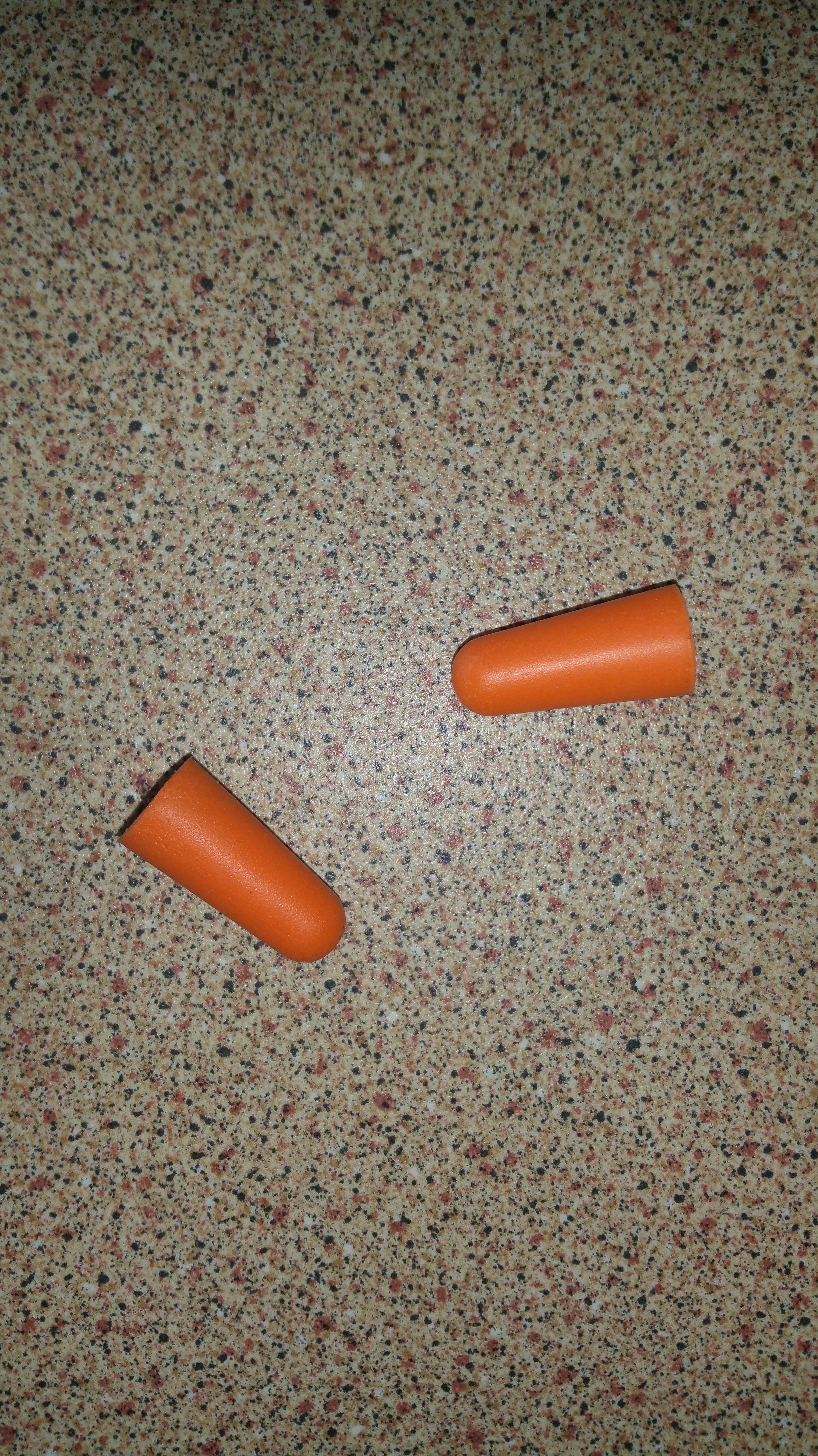

With my P2 I did the following:
- Purchase and ND filter.
- Changed the vibration balls to black ones (harder).
- Inserted foam ear plugs between the vibration balls.
Anyone trying something similar with the P3. Any other tips?

Another trick that sometimes worked on the p2 was to get the soft ear plugs, roll them up as small as possible and put them inside the rubber dampeners. It's something very cheap and easy to try?
Reactions: DattaGroover

On my p2 I took the spare landing gear rubber stickers and put two between the gimbal mount and the bottom of the Phantom cover.. Not too snug, but just a buffer to make the gimbal bracket not bounce around in fast movement. Made a big difference.

You've nothing to lose, cheap as chips to try too.
Just for my own clarification, are you rolling these guys up and inserting them in the center of the dampener on the gimble? And if so, I am assuming you are just doing two since the others have the clips. Sorry, I am having troubles getting my minds eye on this one lol.
Yep roll them up into a tiny ball and stick them inside, after about 10 mins they expand back out to fill out the inside of the dampener. You can just try the 2 if you want, I've used them on all my phantoms but I cut the anti drop pins off and replace them with lose fitting cable ties so I can put all 4 in. Haven't tried it on the p3 yet but I will if I see any jello at all.
