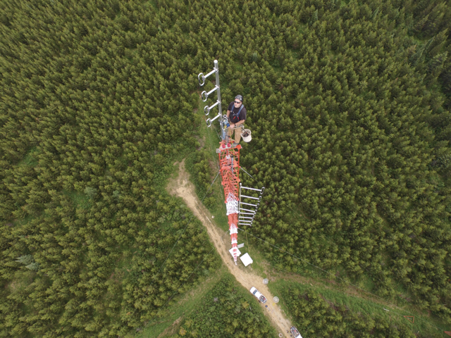

I work on comm towers. It's easy to film them. Self support is the best as there are no guy wires. HahaView attachment 23125
Don't they turn those off before you go up? In the navy it was do not rotate or radiate men working aloft. and I think that's how the microwave oven was invented, a candy bar melted in a guys pocket.
