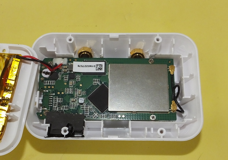

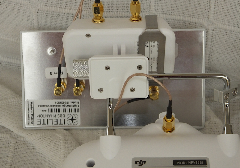

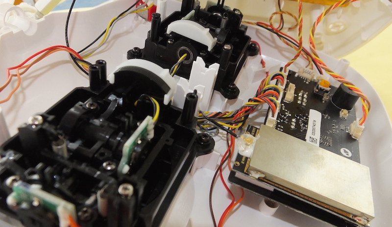

So I did this mod to better position my antennas but haven't gotten the chance to go out and test it yet... life and weather keep getting in the way.
I did the install, no dramas.
A couple of things I did a little differently.
I decided that I did not want the output connectors on the top surfaces or the TX/extender as when I eventually sell / upgrade the filled holes will not be as obvious.
I also routed the extender wires under the circuit board to pop up next to the connection points.
The spongy shield in the extender tears very easily along with the rubber light blockers.
I also de-burred the bracket a little as it had rough edges that would have scrapped the extender.
Also its essential that there is no debris left inside the TX that could clog up the sticks.
I used hot melt glue to fix the cable down in the TX.
Also the right angle connectors must go on the antenna panel or you will find you trying to connect male to male connectors.
Just waiting for the weather to improve now.....

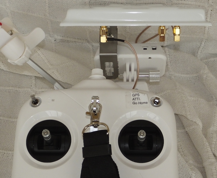

Nice install. The reason I didn't do the rear connectors is that I didn't want the cables getting crimped and bent when I stored the transmitter in the case. I am going to get some more custom braided 90 degree connectors SMA male to RP-SMA male made again similar to my Horizon setup below. On my Horizon set up I installed the connectors on the back but needed to use the 90 degree connectors to stop cable damage.

This must be the Australian version... it looks upside down on my screen here in the U.S. o_O
SOMEBODY MODDED MY MOD!!!
GREAT work sir... there's more than one way to skin a cat!!!
Thanks
The antenna is the right way up but the bracket has to be inverted as the connectors are coming from the bottom now.
Or maybe the imprint plastic panel of the drone is upside down ?
Just going to have a look at it again, just in case.:D
Only half way to Australia, (maybe thats how far it will fly now ) :)
