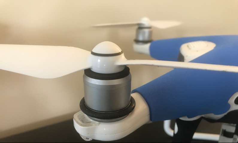

FYI: The Props covers that come with the Phantom Rain Wet Suits really lock in those props and the new Silent props as well. One of the problems we had were props falling off when hitting some leaves , that doesn't happen anymore.
The Covers are made of Neoprene and offer a little bit of give as you push down on the Props to lock them in and the Neoprene helps protect the Inside of the Props from wear and tear. These are the new Silent Props and they offer a really good strong fit as you can see the indent of the Neoprene Covers. Absolutely no slop

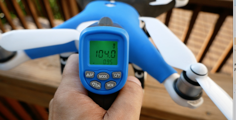

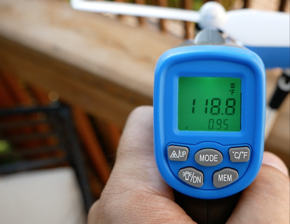

Originally that was one of are concerns also , but the DJI team that we worked with explained to us that the motors would not be prone to overheating even with the top holes covered as they are meant to handle extreme temps as high as 300 degrees . Being that they are made of Aluminum they are designed to negotiate high temps.
With that said we flew in 120 heat in Tennessee for the Total eclipse and the hottest the motors ran after an hour were 128 degree f.
and the battery was 120.
Last week we flew in the 100 degree sun and this is the temps for 24 minute flight for the motors was 118 f
and here is the battery
Just to put some Perspective on it. So the Motors heating are simply not an issue do to the fact that they are made of Aluminum, with
High heat tolerance 300 degrees if not more.
Thanx for that information. That's very helpful.
