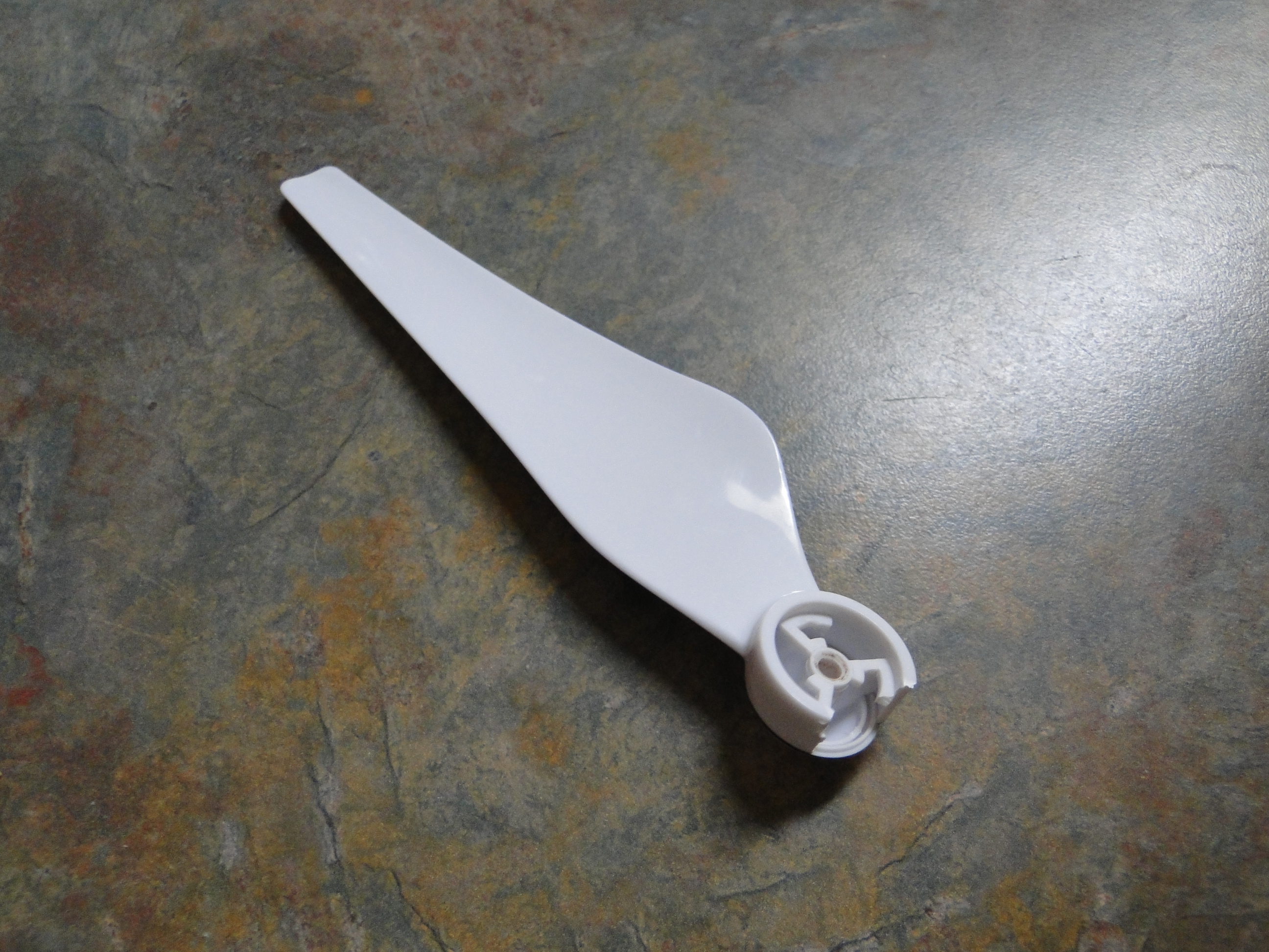

Hey doods;
So it seems it happened again...same problem, same conditions...
Deja vu for me....on a mapping mission this afternoon, I had a prop break mid flight. However, this time I have the prop. It seems this time, instead of the prop hub breaking, only one of the two rotors broke off the hub. So technically, I didn't lose a propeller. I only lost HALF a propeller.
Other than using my Phantom 4 an order of magnitude more than most guys, I'm doing nothing wrong.
So, once again I'm going to ask if any of you guys have seen prop failure. That's really the only information I can use at this point. Or if there are any plastics experts out there, perhaps they can look at the photos of the broken prop and share your thoughts.
Worth noting; the remaining 3 props remained essentially intact. One prop ejected upon impact. I know this to be true because the prop was a mere 8 feet from the drone (as opposed to 200' away had it ejected @ 300').

View attachment 98402 View attachment 98403
It's hard to believe this hasn't happened a second time...especially after DJI assured me it wouldn't.

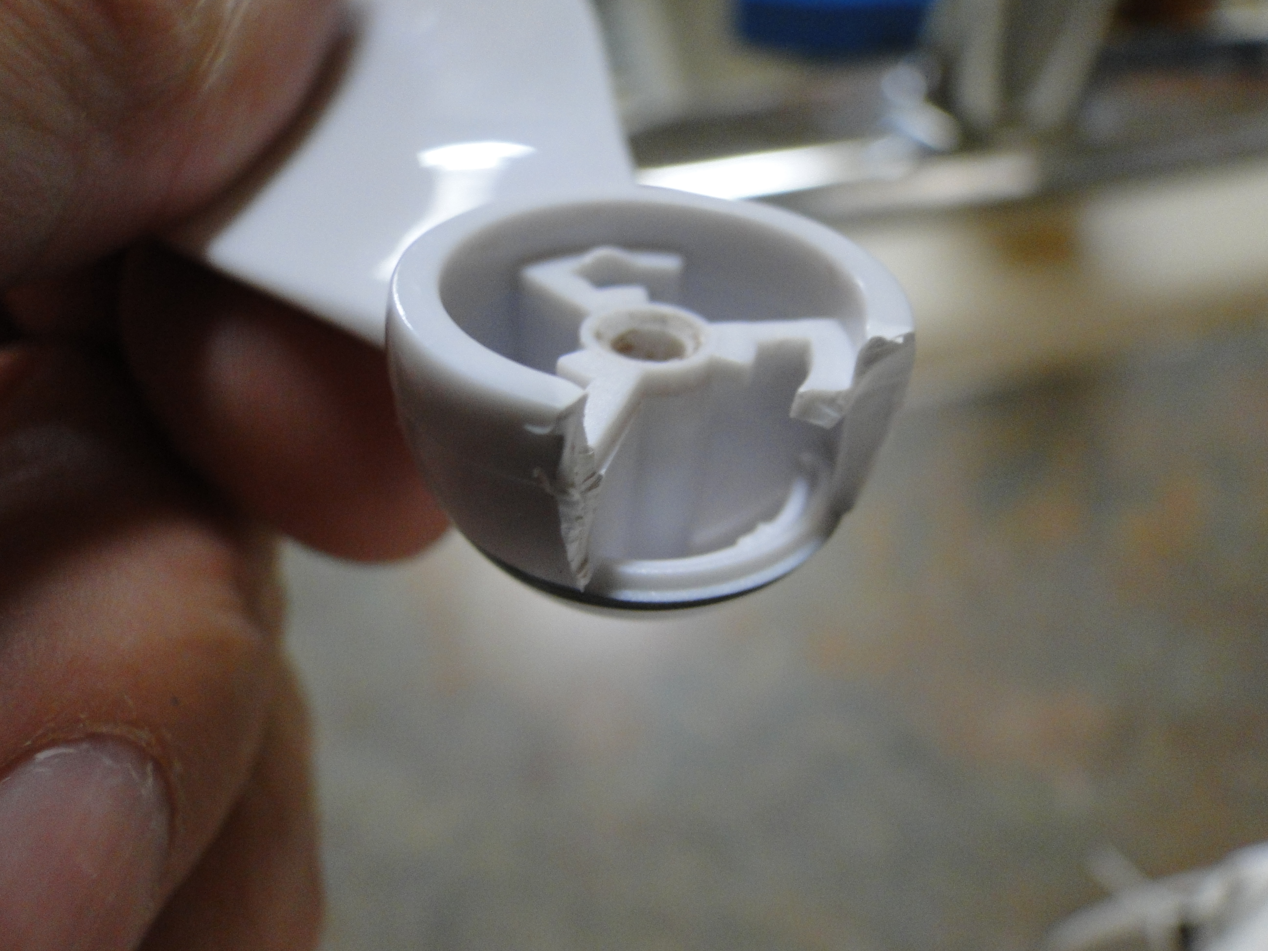

Another thing worth noting, is that I notice the P4P props have the slightest amount of wiggle room on the hub. I can kind of rotate the prop 1° on the hub. They do the same on the Obsidian hub.
The Obsidian props, however, have zero tolerance. They are very tight on the hub. I think I'm going to purchase Obsidian props from now on.

Similar to you, but I've had the whole propeller come off 2 times. First was at 200' just into a mapping grid. right rear prop just came off, and down came the drone. Autopilot was fighting like mad and it landed on the side/one leg. Drone was OK to fly with new props. 2nd time was similar, straight up to 399' and just as it turned to go start the grid, off came one of the props. This time, terminal velocity and impact on asphalt destroyed the drone. Sent it off to DJI, no DJI care and out of warranty, in 2 days they agreed that it was a defect and sent a new drone/RC. I did not find out what they saw in the logs, but it was enough to convince them. That is one reason why I now hole the motors and slightly stress the props after installing them.
You are flying your craft a lot harder than most of us, your speed and turning radius is constant so the forces are repeated over and over and fatigue takes it's toll. The hub has 3 sectors with a 2 blade prop, the prop that snapped at the hub was between the sectors hub joints. The one that didn't snap, the vertical web was in the center of the prop to hub mount. I wonder if your first prop fail would have been at the same place. Looks like one vertical web in the center of the prop was stronger (permited flex) and less prone to fail than the prop with 2 webs, 1 at each side of the prop mount. Her's a maybe without proof or data. The surviving prop has 1 web centered to the hub, the load would deform the hub (more) and some of the forces would be distributed in the hub, the prop that snaped had 2 webs, one on each side of the prop, the mounting in the hub would make this a stronger but stiffer triangulated mount, it may not distribute load as well in the hub and the repetition of the same type of loads caused fatigue and it tore off. Just saying that's what I see without having any more data.
Hi Harley, I had the exact same thing happen to me last year. DJI replaced the copter under the Care program, but didn’t seem concerned about the prop failure. I wish there was a fix to this issue, I am now out of warranty.
All props on my Phantom 4 (standard white props) has some play both horizontally and vertically.

Hey doods;

I’ve been bragging because I flew my P4 on same set of props for over 200 hours then recently it augured in due to prop hub failure. That’s what I get for bragging. Now I have the P4P with insurance. The prop tolerance is much tighter with no wiggle at all. I think over time UV and stress weakened those original props but this does not help you with a brand new drone.
Hey doods;

I'm pretty sure that you have balanced your propellers so as you said it seems to be a failure during manufacture if they are failing like that. I hope you sort it out before you loose a UAV altogether.

Hey doods;

Hello HarleyDude, Yes I had the same exact failure, I saw the one blade fly off at about 30 ft. I have been checking props ever since. I flex them and look for cracks. And yes it was a genuine DJI prop.
